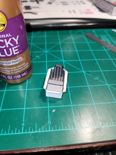

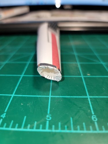

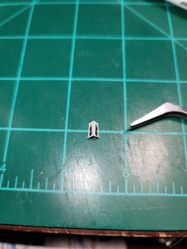

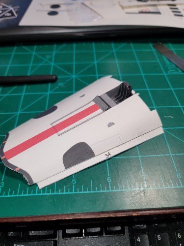

You can see the mistake in this photo...
I had to reprint it anyway because of a baby incident, wand will use the original .

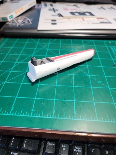

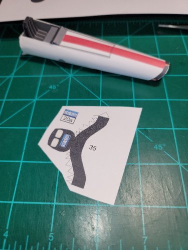

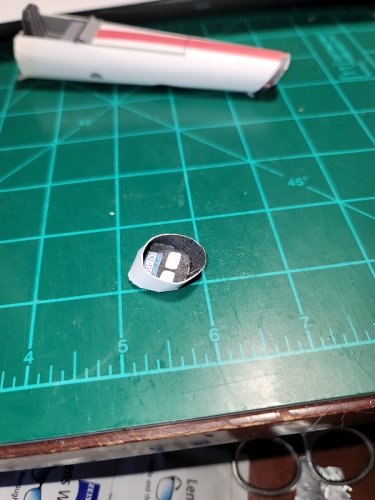

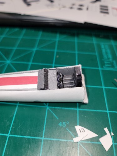

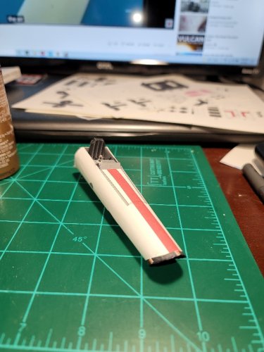

Got the main body tube cut out, pre formed, and the glue strip attached.
and the cockpit tub installed.
next will be closing the tube, and making the front insert.

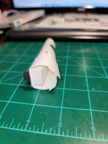

Micah, closing the nose is the trickiest part of the build. I screwed it up once because I did not pay attention to the back plate. During the first test I had to revise the texture on the nose. The issue was noticed after I had already closed the nose. I ripped it open again, assembled the revised nose and forgot to add the back plate. It was a pain to get this in but in the end I did it. This is the reason why you can see some wrinkling at the back and on the sides of my car. So the trick is to pre-shape everything thoroughly and add the joining strip. Then you attach the cockpit tub (like you did). Then attach the the top of the back plate to the back of the nose part. Work yourself carefully around and wrap the nose piece around the back plate. Tackle the side where the joining strip was attached, then the next. Leave the front open to insert a rod for applying pressure. ;)

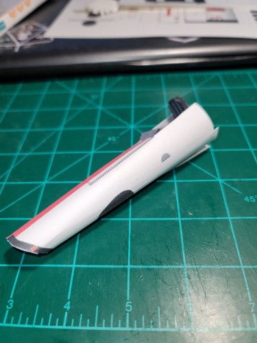

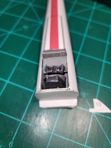

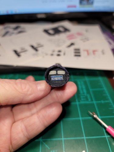

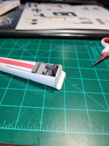

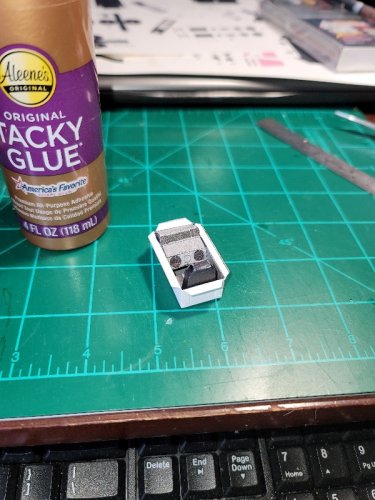

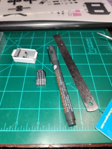

I went against the instructions here, I closed the bottom of the body first,
Then added the back plate #36
then made the front insert, and glued it in...
I know that I missed the alignment a little on the nose, but I'll color the gap and live with it.
Next will be cleaning up the seams, and edge coloring.

OK, you copied my assembly. Very well done! The alignment error is very hard to see, so nothing to really worry about. ;)

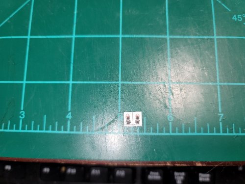

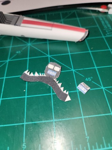

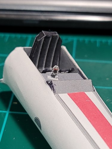

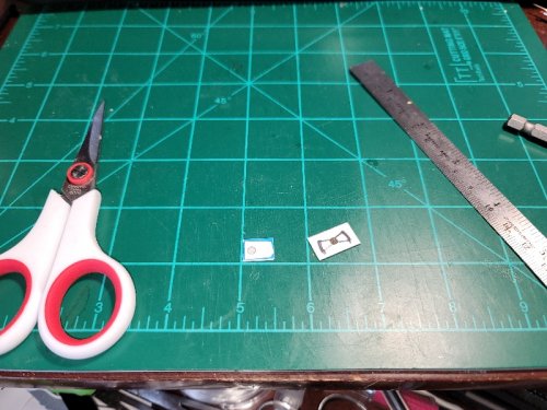

I cut out the little Toaster Bobblehead...
Edge colored the nose to hide the gap...
Installed the steering column and wheel...
Glued and trimmed the tiny Toaster...
and installed him on the dash, and added the front light greebelies.20220109_195602.jpg
Tomorrow I'll work on the canopy and frame.
