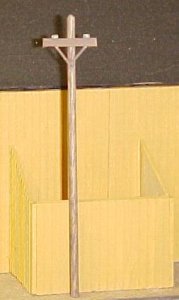

Hi Andrew, When I get bored and just want to sit and do something I'll build telegraph poles...These are HO...30ft old time poles. I use clear "seed beads" from the craft store for insulators. The poles are 1/8" dowels.
String or thread is ok for lines but they trend to collect dust...I don't have any strung right now but also at the craft store I found some very small monofilament line that they use to string those seed beads.... it sorta has a slight greenish cast to it like copper wire and is very strong. I'd say its about the equivlent of 2 or 3 # fishing line.
Hope this helped :)

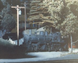

I'll post this pic, the lines don't show well, but they are there.
I turned plastic rod for the insulators, and used surgical silk for the wires. The silk was then wetted with a water white glue mix, which allowed a natural catenary(sag), and when the glue dried, the catenary stayed in the lines, and they were sealed so cleaning off the dust was easier.
While the lines were still wet, I used an Xacto handle to help form the catenary in the wires.
Pete

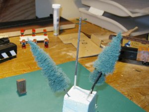

Pictures at last
Here is how my utility poles turned out. Pictured with a few scrub pad trees in "the drying rack". Still need to add the bracing to the poles. Beads were 1000 for 1.50 at a craft store.
Andrew

Pete, I must have missed this thread, that photo is excellant! The transformer, the stirrup steps or whatever they're called, the insulators and general composition of the scene are outstanding.
