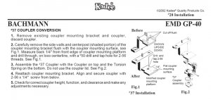

Kaydee MCS vs 37
I had recommended the #37 because the HO set - Bachmann McKinley Explorer should have come with a Bachmann EMD GP-40 engine and the Kaydee conversion list shows a #37 as the appropriate coupler. Here is a picture of the #37 installation document:
Does the current coupler look like the one in the picture or have you got yourself an engine that has been modified already?
(link in case picture too small - http://www.kadee.com/conv/pdf/b10.pdf)
