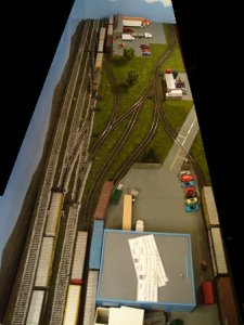

OK folks, i need some help, i am thinking about tearing up 95% of my current HO switching layout, and go for something different. there is nothing wrong with what i have, but after much thought i think a change would be good;).
Staying with my fictitious Union Pacific's "Rock Valley Sub:D", i would like to back date it to 1960-1974. by doing this, i could run with smaller switches then i currently am using, and get a change in scenery. out of the 63 engines i currently have, i have 24 of them that would fit PERFECTLY in this time period. about 80% of my current rolling stock would also work in the era i would like to do:thumb:. i would like to use my 3 buildings(but don't have to) plus more if i can. what i have now is a rail to truck transfer building, a factory, and a Diner. if possible i would like SOME street running, but thats NOT a must. i have 3 tracks i want to keep on as 1- runaround tracks, and 2- as interchange tracks with the CNW and the Milwaukee Road.
Below i have 2 pics, the first is how the 8'x30'' switching layout looks right now. the second pic shows the three tracks i want to keep, and shows the space i have left over(in gray) for ANY IDEAS that YOU FOLKS HAVE to fill that space. i really want to keep the existing switch that goes off the inside track shown, and take off from there with ANY ideas you folks have.
announce1SPECIFICS: the layout is 8'x30'' and the usable amount of space i want to change is 8'x22''. i know its not much to work with, but its all i got. i need room to back in and out of areas with one engine, and at least one 50' freight car. right now the area i want to keep, with the three existing tracks(pic 2) is in the back, i would like to turn the layout around and have that part in the front, but it doesn't have to be. the plan DOES NOT have to be complex, simple is good too:thumb:.
Well, there you have it, ANY HELP or IDEAS ARE MORE THEN WELCOME!!!:thumb: and of coarse, GREATLY APPRECIATED!!!;) THANK YOU!:D-Deano View attachment 36179 View attachment 36180

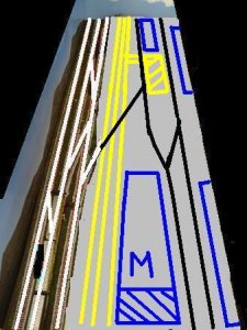

Here's what i come up with, but I'm not sure its the best idea:rolleyes::eek:ops:. the yellow is a road. the outside white track is the mainline, the other two white tracks are for a runaround track and interchange. the black tracks would go to 4 businesses that need rail service. the blue areas are factories or businesses. the blue area with the "M" in it is a merchants row, the blue area in the merchants row with the lines through it would need rail service.
the white tracks would be the front of the switching layout. the blue factories in the back, would just be the backs of them, and only stick out about 2''-3''.
ANY thoughts, comments or re-draws ARE MOST DEFINITELY WELCOME!:thumb: :D-Deano View attachment 36181

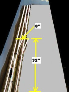

Deano, can you tell me, where exactly the starting point is? Is it in the middle or more to the right or the left? It is hard to tell by your pictures. :wave:
UP SD40-2
Apr 30, 2006
2,709
57
KURT!!!:wave:, do you see where the black track and the white track meet, thats the starting point;). i want to KEEP the white track, but that gives me 8'x22'' to do something new:thumb:. THANKS!:D

Deano, I know that’s the starting point :wave: , but could you give the the exact measurements? I know from my layout, that on such a small layout, it really makes a difference if it is 10" more to the right or to the left.

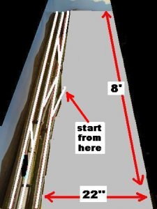

SURE THING KURT!:D the picture is hard to go by from the angle it was taken:eek:ops:. the yellow lines show the start and stop points of the measurements;). i went up to the end of the turnout on the switch. i hope this helps:thumb:. THANK YOU!:D -Deano View attachment 36195

Yep, that helps. I don’t know, if I can come up with someting, but I’m gonna try :) .

Deano, I am no trackplanning guru (and I cannot compete with Steve’s words of wisdom :wave: :D ), but I hope, you don’t mind if I tell you, what I don’t like about your plan :) . All the tracks, buildings and the road are parallel to the front. I fear, it might give the layout a rather static and :)oops: excuse me :eek:ops: ) boring look. And I think, the business in the lower right corner of your drawing is too difficult to reach. I would not like doing all the switching moves that are necessary to get there.
Here is a rough sketch, I did this morning. It is not well elaborated, but it might give you an idea, what I am thinking about. I tried to keep the factory and the diner and included a short street running. :wave:
EDIT: After I posted this sketch, I saw that the factory is even bigger than I had drawn it in the sketch. So one of the two tracks in front of the building had to be removed. The factory is rather big for a layout that size and it consumes a lot of space. It would be easier to do something interesting without it or if it was only used as a background building. And besides that, with the factory, the right side looks much like your current layout.

FIRST, Kurt:wave:, of coarse I DON'T MIND YOUR THOUGHTS ON THE PLAN I PUT UP:thumb:. hey, if i was happy with it, i wouldn't have asked for help;). :D
AS for the plan YOU have presented...I REALLY LIKE IT!!!:thumb: :D :thumb: :D WOW!, looking it over, i think its GREAT!:thumb: and it makes GOOD USE of the tracks i wanted to keep!:thumb:
