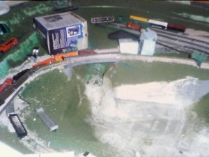

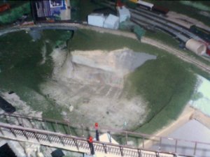

here are some photos of the lake and the pump is in place and i ran water through it the bridges are all scrach built and some landscaping is done to help blend it all in

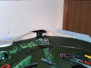

yes have to get the mow train out of the yard. my son hit my power and it shot off the track i have cleaned it up. last night i cut it from a 6x6 to a 6x9 L so i have to rerun the 2 main lines.but the rest would stay how it is and i can add more sidings. my wife was a mad becouse i cut it and moved it the way i did but now i have more room in my train room
the lake is 2 1/2 inches deep and i made it out of one of those
plastic tubs and i mounted it with wood screws and liquid nails on all for sides and the screws are 3 inches apart the whole thing is around 24 inches long and 24 inches wide before landscaping and the return line for the pump is 1/4 inch fish hose from the pet store about 1.00 in price the pump is a 10 gal fish pump and for my dran plug i used a top of a plastic pop bottle and a water shut off valve the river is made of plasic laid in then plaster over it then a water proff paint to finsh it off then i went out side and found small rocks anh hot glued them in and used flat base paint to do the bed in a muddy green color ..
