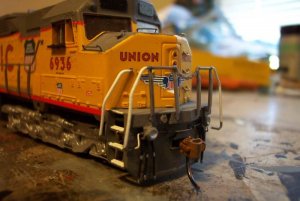

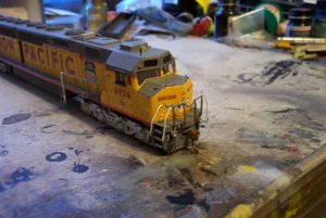

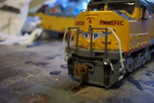

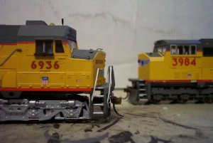

I decided i needed a decent model of UP 6936 for my railroad and i defiantely didnt want to pay for brass so i decided to hack on one of my Botchmann units. I masked off the yellow portion leaving the roof, then I painted the roof with floquil and added the lightning stripe decals. then i removed the factory number and added the new numbers and the uprr.com decals. as for body modifications, first, I cut off the truck mounted couplers. then I cut up some styrene to fil in the gap in the pilot. then I cut a hole in the pilot just big enough to fit the kadee coupler boxes. after all that had set I drilled holes and added the cut lever and air hoses. then I cut up and bent a brass sun shade to make raised mounting pads for the ditchlights. then I added the grab irons, air conditioner, and antenna. there are still some detail parts to add and some decals to finish, but you get the general idea.
