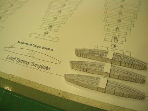

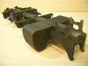

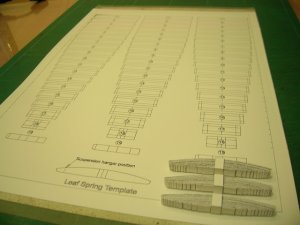

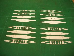

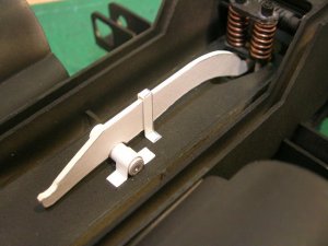

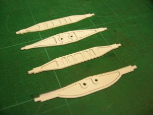

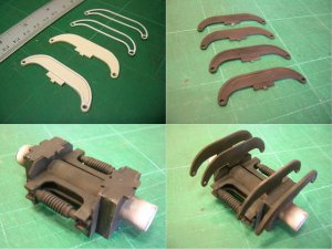

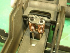

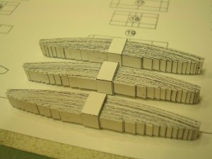

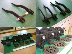

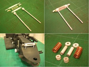

Now I'm building leaf springs. Total 6 sets for front drive wheels. The test 3 sets are ok. One set contains with 18 sheets bending along the template. First 3-4 sheets must be serious in bending (exactly follow the template). After the shape is formed the remained sheets are easier. Just bend and paste along the shape.
----koklik---

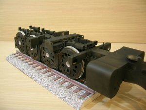

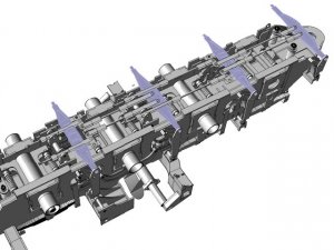

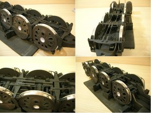

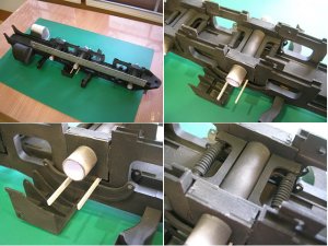

several weeks after collecting suspension parts I tried to finished suspension section in a day. Unfortunately I lost some parts (or i forgot to build them). So the back drive wheel's suspension is suspended for today. I have some more pictures to show.
Cheers

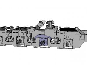

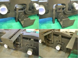

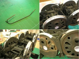

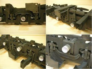

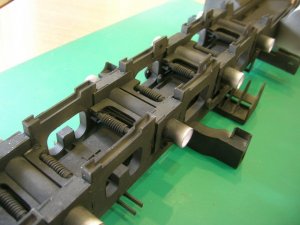

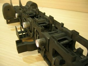

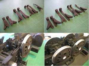

Several weeks , I have nothing to report. I met a problem of how to assembly brake and sand pipe. Small space between wheel and chassis made me to think hard for the assemble method. The way i selected is , putting the wheels to wheel shaft. Then hanging brakes to the chassis. And brake links for the last. Very complecated and tremendous of parts , I did a mistake during brake links assembly. But it was not a serious problem.

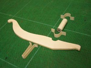

The brake cylinders are weak and complecated I won't install now. I'll continue on side rods. Some parts are very thin. I must pay more attention when cut.

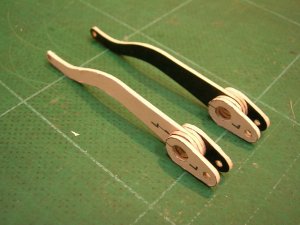

kooklik
Oct 29, 2006
148
Khonkaen , Thailand

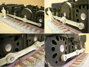

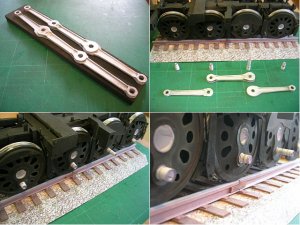

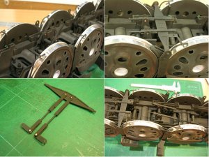

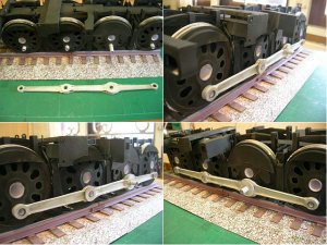

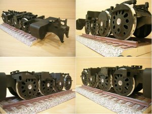

Hi there

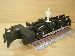

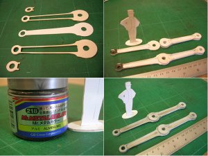

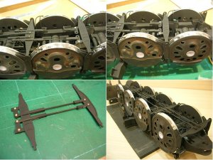

I repaint the rods with black prepaint. Rods are more metalic shine looking.
I tested to fit all rods to the wheels. All rods are strait along the rail line. All were well fit and not difficult to assembly. Only one thing have to be careful is sand pipes which are very weak.
This is my last post for this year.
I wish you all have a very happy new year 2010.
See you next year.
----kooklik----
