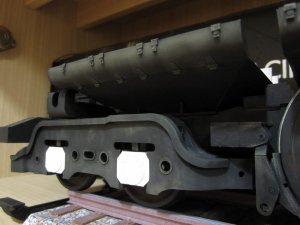

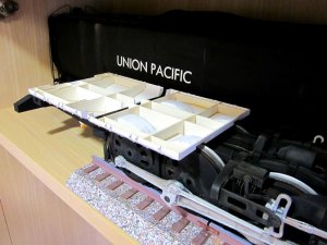

not for dumping ash on rail, there are sand domes and lines ahead of drivers for that. Probably for better cleaning of fire box. Will have t check my references.
That makes more sense, easy access too.

kooklik, hello again. You have noted, but others not "into"trains may not - your "Big Boy" is fueled by coal, has a coal-carrying tender. Coal does not burn as cleanly as oil (also used to fuel steam locos), leaving considerable amounts of ash and other unburnable residue which falls through gratings beneath the floor of the firebox into the ash pans and chutes between the frames (as on your model). During service at the end of a run, the ash would be dropped from the pans into "ash pits" between the rails by folks pushing the ash and residue toward the chutes using tools through these access doors. Oil-fired steam locos did not have this type of accessory - no "ash", but lots of carbon. Zathros, I have been watching kooklik's amazing project since he began it. I know a little about trains...but I cannot fathom HOW kooklik designs, then constructs this monumental piece - alone !...and from "paper"! I am astonished and fascinated - but think I would never have such patience, skill and persistent industry. Thanks to both of you for the instruction and enjoyment ! Bob C.

Thanks for keep following my work and the worth knowledge of the ash pans access doors. During 3D modeling I saw folks beneath the cab floor but really didn't know what they were for. Thanks again for the answers.

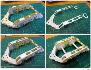

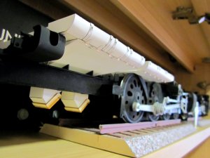

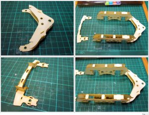

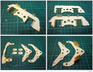

Finished the ash pans

kooklik, hello again. You have noted, but others not "into"trains may not - your "Big Boy" is fueled by coal, has a coal-carrying tender. Coal does not burn as cleanly as oil (also used to fuel steam locos), leaving considerable amounts of ash and other unburnable residue which falls through gratings beneath the floor of the firebox into the ash pans and chutes between the frames (as on your model). During service at the end of a run, the ash would be dropped from the pans into "ash pits" between the rails by folks pushing the ash and residue toward the chutes using tools through these access doors. Oil-fired steam locos did not have this type of accessory - no "ash", but lots of carbon. Zathros, I have been watching kooklik's amazing project since he began it. I know a little about trains...but I cannot fathom HOW kooklik designs, then constructs this monumental piece - alone !...and from "paper"! I am astonished and fascinated - but think I would never have such patience, skill and persistent industry. Thanks to both of you for the instruction and enjoyment ! Bob C.[/QUOTE
Thank you for your informative post. Kooklik's Big Boy is a museum worthy piece, and I believe he could easily have some accept it if that were his wish. If it where left up to me I would put it in an Argon filled glass case with U.V. protection and "oogle" it for the rest of me life. There would also be some "Ha ha's, Look what I got,and you don't!!, but that my baser self! :):twisted:

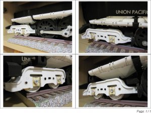

kooklik
Oct 29, 2006
148
Khonkaen , Thailand
Hello there

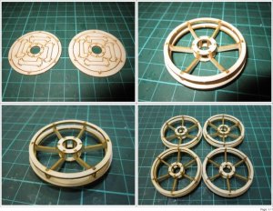

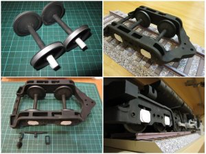

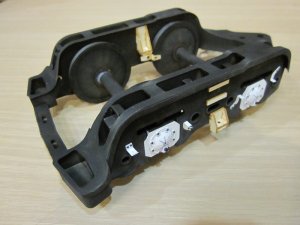

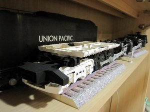

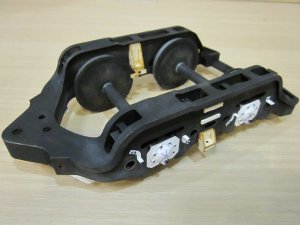

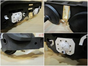

More step to report. I airbrushed the ash pans and trail truck. Suspension parts inside the trail truck were difficult to assembly. But they were OK in their positions in finally.
----kooklik----

The mini forge must cost you a fortune in energy costs! :)
Excellent looking trail truck. It should provide many decades of reliable service!! :)
