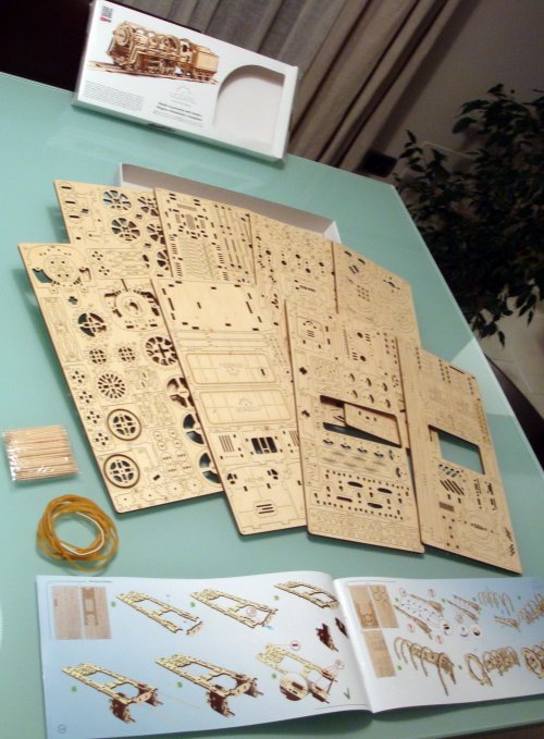

Opening the box you find a nice, well illustrated assembly manual (very well done), several plywood sheets, laser cut, very fine details (some of them seems to be very fragile, we'll see...), a pack of toothpicks (really they only seem to be simple toothpicks, but are slightly slimmer than regular ones I have at home, they are calibrated for the holes provided in model components) and several rubber bands (the engine!).

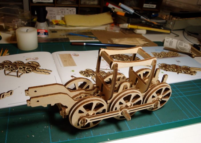

I've just started building it. Very pleasant experience. The pieces come out from the plywood table pretty easily, a sharp blade can help, especially for the tiniest pieces, breaking the junction points prior to extract the pieces from the table, to prevent undesired breaks or damages.
Moving parts need to be lubricated on contact surfaces with candle wax (this explain the candle you can see on the photo) to ease the operation of the many gears and mechanisms. The fitting is superb and the assembling is very easy (this far), very very enjoying... I'm afraid this will be completed very fast!

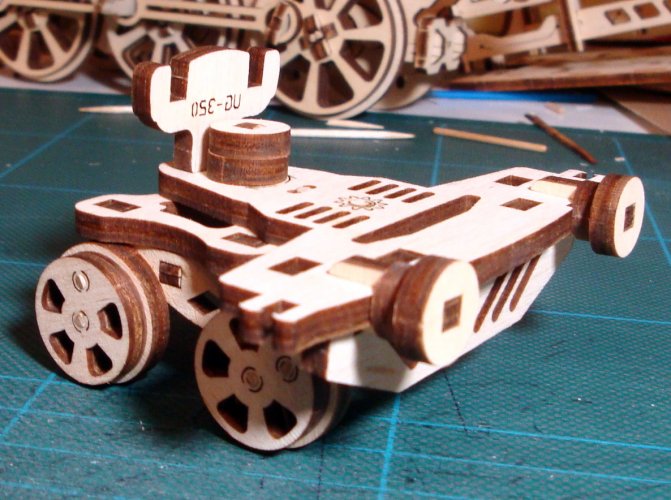

Front wheels

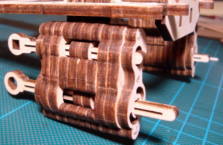

Cylinders.
They have also internal components showing their real functionality.

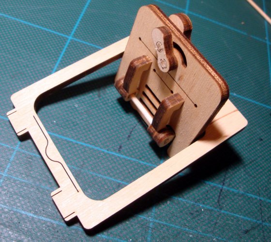

Main body (boiler)

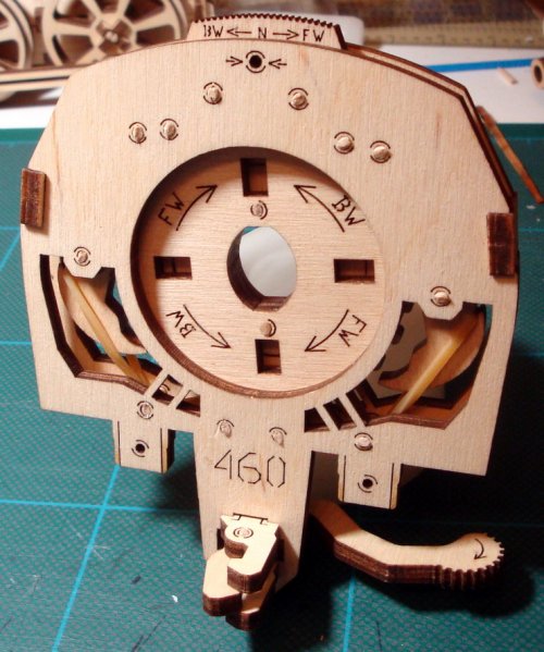

Here starts mechanical wonder. This one is the winding wheel. The upper selector is a sort of shift. It determines the direction that wheel can be turned to operate the loco in forward or backward direction. The rubber bands will be connected to central aperture.
From other side you can see better the hooks that let turn the wheel in only one direction (here they are in neutral position).

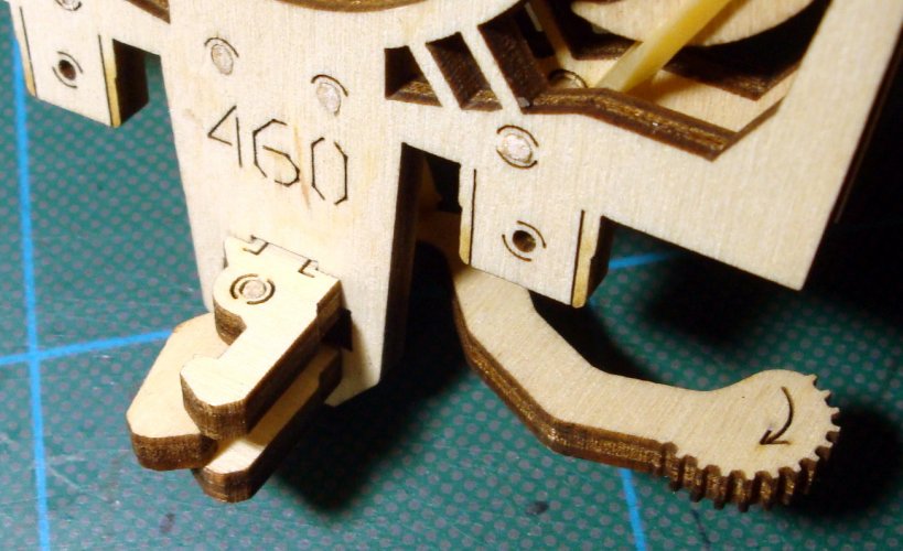

This is the coupling hook where tender will be connected. The lever on the right is to unlock the hook.

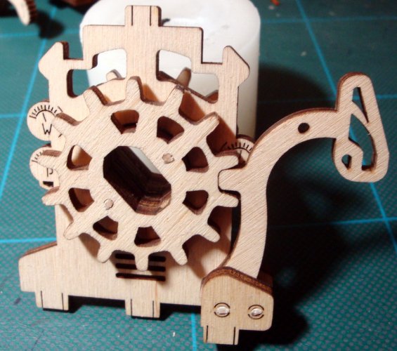

This is the wheel where other extremity of rubber bands will be connected. The lever on the right is the lock-unlock command, a sort of brake. Unlocking the gear the loco will start running.

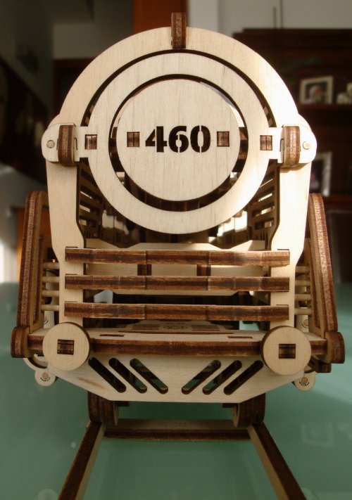

Here it is: the nicest wooden toy I've ever had in my hands.

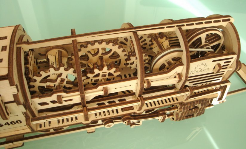

Those gears multiply engine rotation to spin the first front wheel that act as a flywheel keeping constant the movement speed.

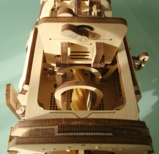

And, seen from the cabin ceiling window, here we have the mighty rubber engine!
Here you see the main start switch, releasing that gear the train start running.
