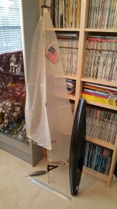

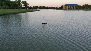

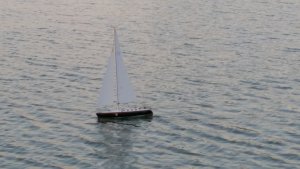

Been ten years I last sail this boat. Took me most of the afternoon to repaired broken parts and put in a new receiver, and off she went! It was a beautiful day for sailing. I think the water is deep enough for my bigger sailboats. I am going have to get the big boats sea worthily too.

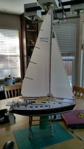

Wow! that's tough luck if you don't like confined space.

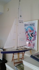

1st, U.S.S. Good Duck I. 1 meter, need new paint job and new remote. 2nd, U.S.S. Good Duck II. 22", need to see more water. 3rd, U.S.S. Good Duck III. 1 meter, under going complete overhaul. My fastest race boat. Need a lot of love right now. She will be seaworthy again, hopefully soon. <3

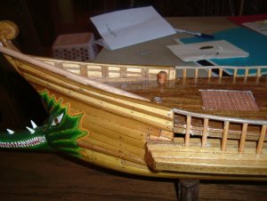

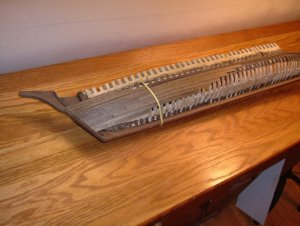

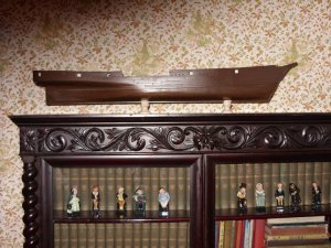

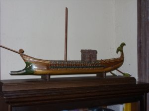

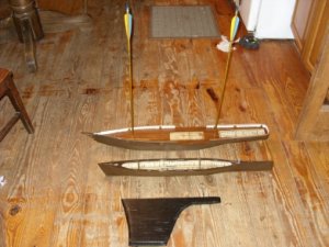

I have two R?C projects that are on hold due to my lack of knowlege about R/C. My first was a Roman bireme. I built a working or mechanism. but the mechanism was too heavy, It took on water, and the radio got strange.
My other project is supposed to be a side wheel paddle steamer it has a split hull, built up plank on frame. I have a removable sailing keel, that is interchangeable with the display stand, so it floats nicely.
I found that aluminum arrows are a perfect fit inside a spent 38 special shell, so O can have removable masts that fit in shells built into the stout deck structure. plan to have all the electronics, except perhaps the battery in the upper hull section. so the rigging , paddle mechanism, steering and such can be fully accessible from underneith.
at a standstill currently due to a lack of time. as well as not knowing how to set up sail to RC.

Those are beautiful works. It they served as displays only, their beauty would be well served. ;)

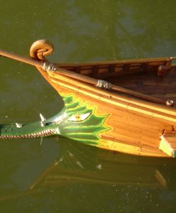

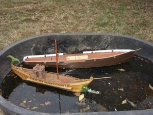

They both float nicely. the bireme is only about 20 inches long minus the bowsprit. I should have built it tice that size, and it would have been able to support the oar mechanism, radio and batteries.
am working on milling out some of the oversized frame work to lighten it, and will want to build a more simplified lighter oar mechanism. the last one used full size servos with the stops cut out that worked as reversible motors. I had right and left oars on separate channels. will probably try to link them. and possibly run them off of a mini servo to save weight
the paddle wheel and rudder will be easy, need to figure out how to work the sails, on the paddle wheel steamer, which will be rigged as a schooner or ketch.

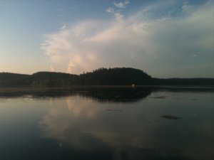

I'm pretty much wedded to the idea of a wood hull. nothing looks as much like wood as wood. and the construction details for wood look right. Just have to learn how to do RC also need to dust this model!
below is the view from the dock on our lake house, so there is some real sailing room, and this is just the bay. Kentucky lake is the largest man made lake east of the Mississippi.
