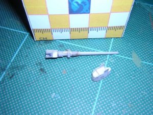

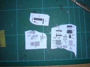

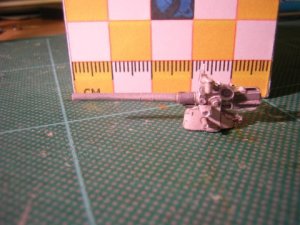

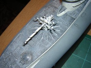

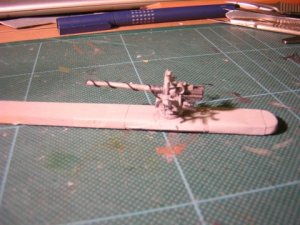

and so on to the 20mm C/30 Flugabwehrkannon..
Not too many parts. A few I didn't use and replaced with wire.
I had taken loads of pictures, but on review, I found most of them blurred. :(
Anyhow, you can see the pre-painted built up parts and where I have substituted to make more rounded depth.
Overall, the piece wasn't that difficult to build, but the instructional pictures were a little hard to see. I ended up searching the internet for real images of this Flak gun to get a better feel of it and to see where I could enhance detail such as adding various thickness of wire to represent the counterweight and dampener.
I was looking forward to these parts from the outset, and the challenge of this and the 8,8 deck gun are what drew me in to giving this a go.
Photo to follow of the 20mm installed in the tower, and then on to 8,8 deck gun.

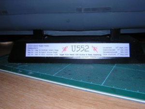

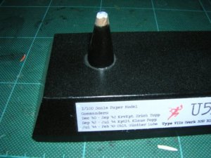

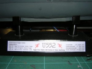

The stand design that Udon created for this model is quite good.
However, I have found over time as I fixed the stand to the model quite early on to protect the rudder assemblies and forward dive planes, that with all the handling and general moving the model about, the stand became wobbly and the model started to list.
There is a weak point in the design, in the point where the cone fits into the box section that cradles the keel.
If you intend to make this model and use the supplied stand, then I would recommend inserting dowels through the stand into the model for strength.
I started down this path but actually opted for a different solution...
I cut the cones off and mounted the box sections directly to the base.
I think it is a better solution, in that the centre of gravity is brought down and there is more surface area holding the model to the base. I actually think it looks better too.

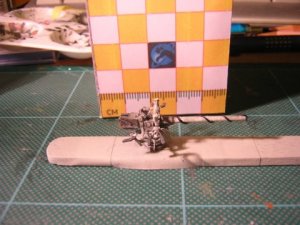

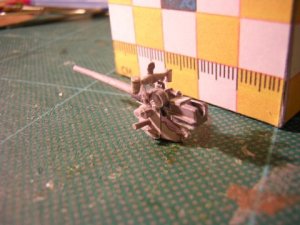

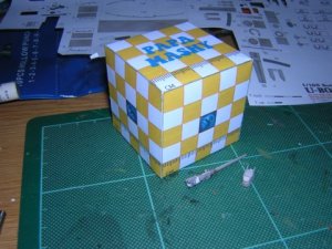

8.8cm SK C/35 naval gun construction...
I've also created my own "cube" from scratch for fun, which maybe a first tentative step toward designing... ;)
Need to get this model finished before winging off down another path!
This is probably the the trickiest piece of the whole model, and actually a reason why I chose to build this all that long ago...
This was a real test of patience.
Unfortunately, this is right at the very end of the build and my enthusiasm isn't as high as when I started. (Probably because I've take soooooo long to build it and I'm itching to do something else!)

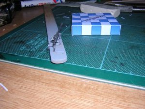

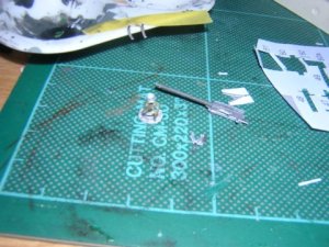

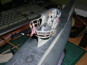

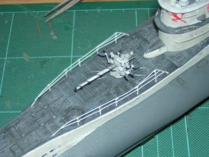

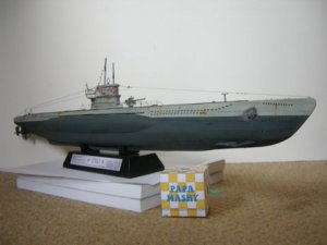

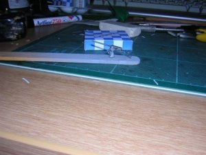

8.8 Deck gun completed and installed.
Next up were the railings.
For this I had a go at soldering...
I'm not the most proficient but practice makes perfect. So it's said.
I had tried making these previously using CA glue but that didn't turn out well.
I was happy enough with this first foray.
Railings painted and fitted.
Really is on the home straight now!
Cables, aerials and final weathering to go. :yesyes:

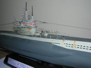

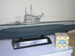

Final touches now..
I made up some victory pennants as I want this model to depict the returning vessel.
There are lots of variation for these as they were made by the crew on the return journey to port. Some had borders, some had the boat emblem, some just had "Frachter" or "Tanker".
The tonnage were estimates by the crew so tended to be rounded rather than actual GRT.
I did a little research and settled on Klaus Popp's 8th patrol for no other reason than this was 52 days long at sea, (mostly on the U.S East Coast) with a high number of successes and long enough to attain the corrosion levels I wanted to portray. (Make it rusty and lumpy to disguise my bodges and rough areas on the model ;))
Depart - St Nazaire 7th Mar 1942
Return - St Nazaire 27th Apr 1942

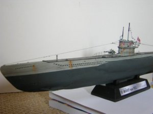

Simple enough to create in Inkscape and make.
Final weathering completed and model done! Phew. :Drinks:
