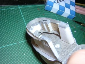

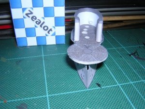

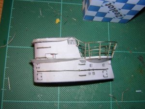

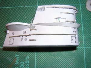

I was concerned that I had used too thicker card for the deck plate and the top half of the conning tower was not going to seat properly due to the position of the navigation light inserts....
I got away with it. Just about. It was very tight!
With that potential problem out of the way, I moved on to further assembly of the conning tower.
Along comes another tricky bit...

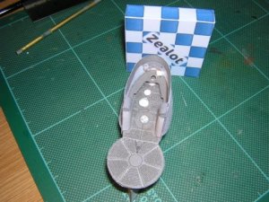

The footplate that sits inside the conning tower, needs to sit atop the nav light inserts, and accommodate the cylindrical recess at the front of the tower.
This took some considerable effort to fettle into place.

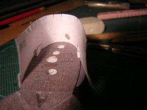

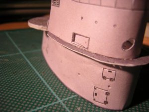

Along comes the next challenge.
The outside fairing gave me some grief. It comprises of a strip of paper that needs to be curved to fit the shape of the tower, but also curved in the opposite plane to flair out. There are a series of triangles and small rectangle strips to support the fairing but the instructions here were not overly clear.
So, I thought I'd be clever and fit the rectangles (this provide the gap between the tower skin and the fairing) & triangle supports first...
DON'T DO THIS!!
Because the fairing strip is curved in two planes, it doesn't want to conform to the shape dictated by triangle supports. All that happened was the fairing strip lost it's shape and the pressure used to try and get to conform caused it to start to show the underlying supports through to the outside surface.
Cursing, I ripped off the fairing strip and cut the triangle supports off. Grrrr...
Attempt 2.
This time I formed the fairing strip and glued the top edge to the rectangle strips attached to the conning tower. This then allowed the fairing strip to take the shape naturally and the support triangles could by slid underneath and adjusted as necessary to support without distorting.

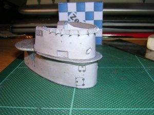

Fairing out of the way. I moved on to the box for the RF aerial
Now on to fitting handrails and other external parts before paint...

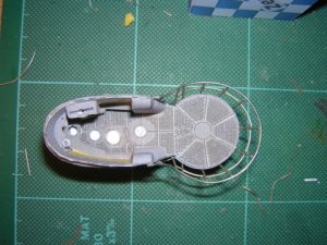

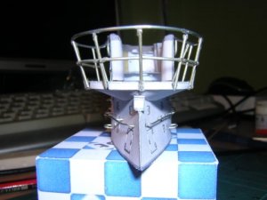

Wire, wire everywhere...
The two plier technique for straightening wire is a great tip and without it, I'd have been struggling even more. Thanks again!
So, with that, I've added the various rails, steps and the 'basket' around where the AA gun is situated.
I'll not lie. I found creating the 'basket' very challenging!
I tried working from the paper piece, but that didn't work as there are a lot of bends and curves that the wire just wouldn't quite take on in a uniform way without introducing various twists and irregularities.
After several fruitless attempts, I finally just cut the uprights to the desired length, made an approximate hoop for the top rail and worked my way around by eye. (after marking the positions on the conning deck from the paper version.
There is some clean up/repair work to do before paint, which will hopefully pull it all together.

A magnificent job! The wire is not easy to handle, you have achieved it superbly.Question: what material is the wire and what glue did you use? In my case, test an infinity of glue, none works correctly, at the slightest movement they break off. of copper and welding achieve very good result. With glue always fail.
Reactions: Papa Mashy
Papa Mashy
Masher of paper
Jul 29, 2018
158
269
40
East Anglia, UK
I used some old fuse wire I had knocking around. (30 amp)
The glue used was CA. I this case Gorilla gel super glue brand.
I did think about soldering, but the difficulty in holding the pieces in place put me off.
There are some more deck rails to do, so I'll experiment soldering on those as they are flat and should be easier! :bulgeeye:

Looks Great!
Yeah, the soldering method works better, but like you said, holding the wire is a problem ( hint: try alligator clips ). After soldering you can sand down with a needle file or emory board ( you can do the same with CA glue as long as it is a STRONG BOND)
I refer back to me trying to solder a turnbuckle with some salvaged wire, that I didn't know came out of an old motor! Really hard to solder when it's magnetized!!

Everything is a matter of ingenuity and practice. Holding the wire is the key, then welding is simple. What I do is on a board position the wires and fasten them with small strips of painter's tape, so they do not move, then we solder without problems. If we exceed the tin there are several solutions, heat and remove the excess, filing, cutting, etc. Another disadvantage is nearby welds, sometimes the heat transmitted by the wire causes the previous welding to detach. In these cases a dissipator between solders resolves the problem, a simple aluminum bar supported on the wire to be welded helps a lot.
