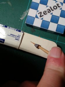

Then I stopped, went away and thought about it and came up with a new tool and technique which I'm sure most of you already know.
Firstly, using a bamboo skewer, I could shape the cone section by rolling the piece into an eraser.
This produced uniform curvature without lumps

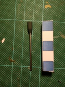

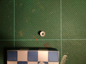

As you can see the after (bottom) prop shaft is much more uniform without as many creases.

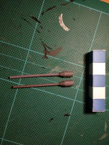

Painted up
Sorry it's a bit blurry, but you get the drift.
