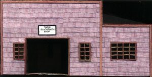

This is a 1:48 scale model of my grandfathers blacksmith shop. It will be a s'prize gift to my father. All that's left to do is the doors. And add a little more jumk to the interior. Real shots soon, meanwhile, here are some scans.

Jon Didn't you post the original picture of that building in another thread? Can't find it. Or am I dreaming? Its lookin good!

Hi Jon,
Excellent workmanship my friend, you Dad sure will be pleased with that.
Now then, when you feel upto it, make it again in 1-48 for me, save me making it. LOL

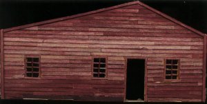

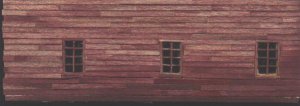

Thanks for the kudos, folks :)
Chris, the scanned images are the front, then one side, then the back, in that order.
Phillip, I don't think I posted it elsewhere. If I did, I'm getting forgetful!
Steve, yes, I will put it on a sceniced base. I was thinking about using 2" foam, then making the sides into blasted rock, leaving some flat spots to glue a photo of the original shop and/or grandpa.

Robin, it's styrene Evergreen "corrugated steel siding", I think with .040 spacing for this "O" scale model. There is a much finer one available suitable for HO and maybe even N. I can get the part number if you like. Al I did to it was glue on some thin styrene rectangles for patches, make some 1/8" x 8 scale feet (2") thin styrene "caps" for the peak, spray it with silver auto touch up paint, and weather it. The usual dry brushing several rusty colors, dull coat, black wash. This time I used ink/alcohol wash, which I think is best on wood, but I think black paint/soap/water is better on plastic, and I might hit it again with that mix. But I did leave out the ink/alcohol mix, and the next day half the LPBs had little black lips, so I "recycled" them on the spot.
All the interior is bits and scraps. The anvil and tools are my usual little brass work, and the forge is the nose off some overgrown diesel body from the scrap box. Interior "wood" is scanned/recolored/printed exterior wood. The exterior siding and window frames are home cut stripwood, stained, cut to 8 ft. and glued to thin corregated cardboard.
