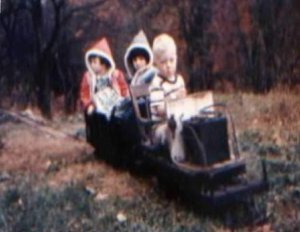

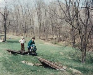

Yes, We used a 7 1/2 " gauge railroad to haul firewood to the house.
As far as being practical, :confused: It worked out rather well for us. It was a bit of a distance to the woods and we were able to bridge a few areas that would have been tough to get a wagon through.(stream and swamps)
During the winter snow was easily removed from the tracks by sliding a snow shovel along the rails.

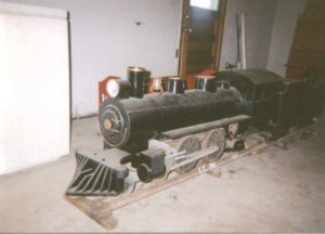

The locomotive and car have been rebuilt several times.
The locomotive was originally an 0-4-0T, It was driven by a rewired 6 volt automobile starter motor with belt drive to one set of drivers and powered with a 6 volt automobile battery and a 2 position switch, forward and reverse.
Later the drive was upgraded to a 12 volt automobile starter motor with chain drive. A 12 volt deep cycle marine battery was used and power was routed through an H bridge of starter relays.
I later rebuilt it into a 4-4-2 with tender.

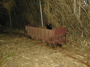

The car was originally a 2 bay hopper, when it was in need of serious repair, a 40' flat car was built and the trucks and couplers were swapped.
I later rebuilt the hopper as a 3 bay hopper.

Russ is right the old line was in western Pa.
Some of the track may still be in the woods. I brought the locomotive and car to AZ with us. At the moment they are at my brothers machine shop at his place in Humboldt waiting another rebuild.
The plan is to lay some track there in Humboldt.

You got that right as to the original starter motor,
It would spin the wheels at start if you didn't feather the throttle.
A motor and electrics from an electric scooter may be an easieer way to go. We didn't have things like that available back then.

That's pretty cool Ray! The picture with the cat is cute. "CatZilla rides the rails in search of another city to trash". sign1
