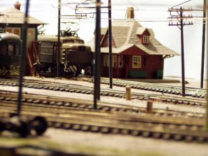

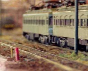

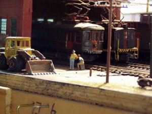

In these shots you will see my old L/O and the big yard, I had a lot of switches to operate here, I did not want electric throws so I used this old method.
interurban

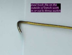

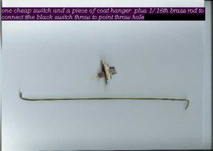

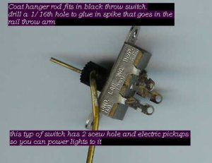

Here are some self explained pictures of a cheap way to throw your yard turnouts.
Hope this helps CN1 :thumb:
Keeps your hand from under the wire. :wave:

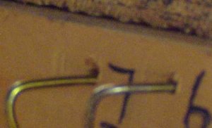

For the viaduct, use peco switches as they have a strong spring, the use 1/16th brass wire and put two bends in it one under the switch and one outside a few inches away as space allows lock it in place wich wood overlays.
this is done on top of the bench.
This close up shows you the red covered brass pull push.
This Help?
:wave:
interurban

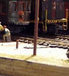

Glad to help here is a close up I just notice the big yard had one fitted.
:wave:
You will have to chisel a small channel out to put the wire down to bench level.
