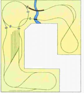

I have given the layout a little more study and thought. Hope you are not tired of me by now. Wanted to mention the following two items to you:
1. Atlas O only makes 36" turns, not 31"
2. In the siding/spur area the size of cars will only lend itself to 2-3 cars per siding. In addition, the switching will get kind of expensive. Any other thoughts in this area.
If it is not asking too much, how can the plan be modified to satisfy these two issues?
Thanks more than you know.
Mark
TrainClown
Apr 17, 2003
861
Saskatchewan, Canada
Re Re and Re
Hi Mark,
Well I think I got it right this time. Smallest curve is now 36" and the yard has longer spurs/less turn outs. Otherwise everything else is the same. You don't have to put in all the spurs right away. You can add them later on as needed.

You are awesome! It is like I have my own private layout designer. When can you start building it? hehehe
Seriously, could you send the plans in the mail that have the additional detail?

Now that we have agreed on a general plan, I will work out the details. I'm having fun. It's like building my own layout bigger than I have room for. My own layout space is only 7.5'x4'. :)
I will send the plans as soon as they are compleat.
I'm not sure how detailed you want me to get.I'm going to supply the basic building plan for the base, and track elevations, scenery construction, basic wiring, and the removable portions.
But do you want to add your own roads and buildings? I figure this will be a fun part of the construction and a personal one. Once you have the basics built, the rest will fall into place. This also would give you time to think about exactly what buildings and industrys you want and have room for. What do you think? I can plan out the roads and stuff if you feel intimidated by that.
It's up to you.
You will also have to decide how high off the floor the layout will be. Basically, do you want to stand to run trains, or sit down. Higher off the floor makes it easyer to get under the table for wiring and such. Tall layouts are harder for kids to see. You don't have to decide this point until construction day.

I wouldn't mind if you plopped some roads in the layout design. Could always vary--but would be curious to see your thoughts.
Will most likely sit to run trains. I have a 7 and 3 year old and want to make it easy for them.
If possible, would like to see your plans for building benchwork. Am not sure if the software you are utilizing is capable of this.

Plans are coming along fine. About 60% of the layout is on a plywood base, the other 40% is open for tack supports, this will be covered with scenery. I need to know what kind of power tools you have so I can take that into consideration. Bench work design is all there and I am working on the track support system. I am also designing the backdrop structure as well with rounded corners (if you want to use that). I will provide sketches of how the various parts will be assembled and how they could potentially look. Have patience my friend. ;)
