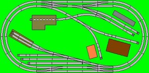

Hi !
As I said earlier, me and my wife had to move, and the new house did not have enough room for my 3x7 N scale layout, so I had to store it and start from scratch, but smaller.
I seached the net for some cool 2x4 layouts, and found many. I picked one I liked, and modified it a little bit, and I can up with this one.
It actually comes from Mike's small trackplans page at http://www.naisp.net/users/mfischer/m_train2.htm (look at the second trackplan, I modified it just a little).
This layout would bring me:
- Operational challenge: all spurs are traling-point except one that's facing point
- Runaround capacity: so I can just let the trains roll
- Enought trackage: so I'm far enough from a simple oval with spurs
- Enough space: there's still space for roads and scenery
- Many turnouts and a crossover !
- Easy wiring: no reversible blocks needed
- A yard: I love yards :)
I'd like some comments on this trackplan ... any toughts ? Do you forsee any problems, or could you advise any good modifications to this trackplan ?
Thanks a lot !

Hey Alex -
This isn't so much a comment on the track plan, but if you can find any way to make it wider you might be a lot happier. Even an extra inch would allow a little more room for structures/scenery along the outside edge and make the chances of a derailment causing a plummet to the floor a lot less. Going from 2 X 4 to 2-1/2 X 4 could open up a whole realm of possibilities!
Russ Bellinis
Feb 14, 2003
4,501
76
Lakewood, Ca.
Do you need or want a double track main? If you single tracked it, with a passing siding at the industrial section for a run around, you would have more room for scenery. The run around for the yard could be in the yard. A turnout on the right side would then provide a nice yard lead.
