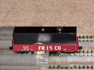

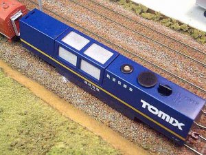

Nick,
Here is a photo of the Tomix track cleaner.
You can see the motor's bearing sticking through the top of the body. The motor drives rail cleaning discs (or a vacuum impellor) below.
You can also see the black cap covering the cleaning fluid reservoir.
The control knob has three settings - "On", "Off" & "CL Power" (you need a Tomix controller for that. It delivers constant voltage to the tracks - usually for headlights - regardless of loco speed).
The removable section of the body covers the "dust chamber" which collects debris sucked up by the vacuum.
Gavin

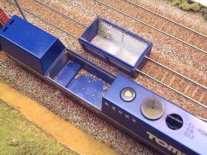

Boy, I'm having lots of problems getting into "The Gauge" site at the moment.
Then when I do get in and post a message, it takes forever to come back with another "page not found" message. I try again and get "Sorry, the moderators only allow one post each 30 seconds" (huh?!)
I try again and, yeah, sure enough, the message appears TWICE - sorry about that!
As you can see from the photo, after one lap around the layout in vacuum mode with the underbody track "brush" fitted the unit has picked up loose grains of ballast and fluff/dust (in the hood).
Here's the photo I meant to attach to my first post (I got them in the wrong order).
Gavin
