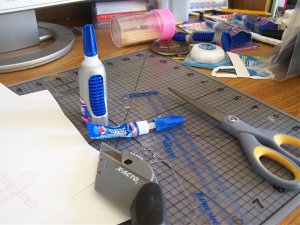

Alright, so let's begin Gathering some supplies for this revision.
What you'll need:
Ruler
Scissors
X-acto
Super Glue -Loctite Super Glue Gel control, and Squeeze
Why do we need the ruler?
Well...Ask this guy ------> :excited1: -"Why's it always me...-.-"
:excited1: - "Anyways, to answer this question...You need the ruler to expand the paper space, if you will, where the piece thins. This way, you can avoid ripples. To bring it back to its original form after, just trim off the excess lines traced by the ruler."
Exactly what we're going to do!

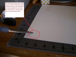

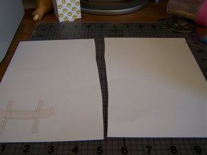

Step 1: Cut paper in Half.
So, you printed that page with the first piece on the front, then the piece on the back. Then after, flip the page over so you can see both pieces. More detailed explanation in the photo's.
- Guide will continue after a short break of maybe 4 hours, sorry. I have an urgent emergency going on here.

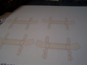

So, since I'm like, "The Tester", I'm going to try out my technique to fixing the ripples. So give me some time, I'll make sure to post the rest of the steps.
*There will be no joints for the ankle. I did say somewhere prior to this post that I would add ankle joints. I am truly sorry, but I won't be making any instructions for the ankles, only because I want to speed up the process of finishing. Sorry, if you want instructions for the ankle joints, I can PM the rest of it.
