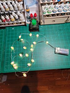

Dollar tree LEDs, a string of 20, now 19 cause I tested cutting them off, 2 AA batteries, or a single 3v Lithium Ion cell.
I Scavenged some blinkie LEDs from a Dollar Tree tombstone, that my wife had... Shhh

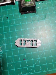

And the back piece of the engine cluster already opened up...

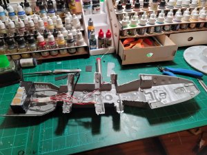

The kit is older than I thought, it's a 1997 reissue. I am proceeding apace, gears in my mind rolling about how to make a "light box" that will fit inside the 'Star Drive' section of the kit, then reflective coating inside the main body, so just a few LEDs can light the whole main body, then short fiber optics thru to the outside.

Just got my monthly check, and I'm already broke again, ohh well, such is the disability life. For the light box, I have one small piece , maybe 6 inches square, of black styrene, .040 inch thick, I'll make the light box out of that, and point the lights toward the thrusters. Then when the model is off, it will just look like the Battlestar is 'powered down'.

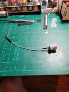

The fiber optic kit comes with 6 small 'light boxes' to hold 'grain of wheat' bulbs close to the fiber ends. I'll use these to old the LEDs that light the fibers...

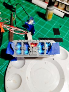

The light box is made for the engine cluster, the LEDs are colored, and installed, light diffuser made, and wires extended.
I did the basic paint on the rear plate and this is how it looks so far.
just mocked up at this point to show off.
And a short video to show the pulsing effect.
