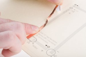

Graphite is a horrible conductor, and circuits made with graphite require a lot of amps to work. LEDs use a forward bias of up to 3.5 volts, and very little amperage. To have to use a 9 volt battery, when a 1.5 volt battery would work shows how bad graphite works. The pens the lay a trace of conductive epoxy are a much better way to go and require much less electricity to run, but for long runs are expensive. I believe that's what Rhaven told me he just got. I did the graphite experiments when I was a kid, but the limitations of current loss do the resistance makes them fun, but impractical. For lighting up a model and having no wires, the conductive epoxy pens establishing the contacts, and copper trace tape, are the way to go.

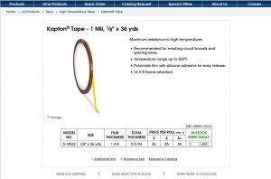

Copper trace tape can be had for pennies a foot. The Kapton tape is 1/8th inch wide, you have to buy two rolls, for $6 dollars, and it is 36" long, each roll. That's eater than wires, and you use the Conductive Epoxy to attach to the components.
Imagine the clean insides of models, all the electronics hidden, and the slightest movement of a part, like turning an antennae, and the whole ship comes to life. ;)
