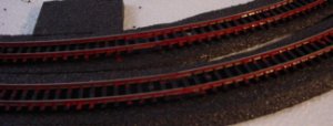

I painted mine too in Nscale using a 00 brush. Takes a while and plan on three coats of paint. I found taking a picture of the track using a flash exposes all the places you missed putting paint on. Choose any color you like and try it out. It takes a while since you'll be trying to be somewhat careful and the work is small. Get out your brightest light to see the rails, and put the paint in a wide mouth container to reduce your chances of spilling the small mouthed container with the brush. (Yeah...been there done that.) Check out my rails in the gallery pictures...
