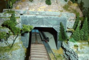

I built a few wooden tunnel portals from a drawing in a RMC or MR. (Didn't find the drawing at the moment, sorry! :()
This one is on a H0n3 diorama (scenery is not finished - no, that's not snow! :D)
As you see, the timbers really are on the heavy side, I'd say in the 12"x12" range.

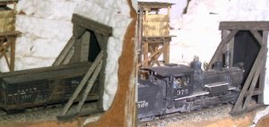

And here another one, this time in N scale.
Again, the timbers are quite heavy. For sure they are more massive than the ties of the RR track.
Ron

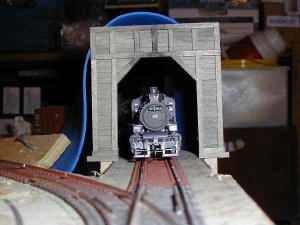

And here it is...
Thanks for the help everyone!
Here is what I came up with. The blue "hill" in the picture is just to make things a little darker in the "tunnel" so you get an idea of how it will look.

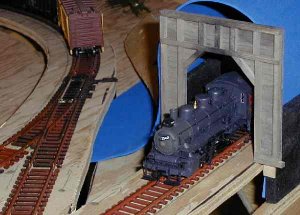

Another shot
I will add the external bracing (a la Railron) later. I built the portal from "funwood" - it is also from Midwest, but is cheaper, and not really "to-scale" sizes.
This is my P2K 0-6-0 hauling the local run.
