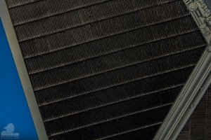

As for the texture, here are some closeups of the coolshade material used on the original:

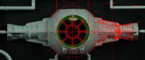

So if you coose Bandai scale too, as it seems you did, use their model as a reference. Their model is realy close to the original, as you can see on this comparison with my model based on the known measurements of the original:

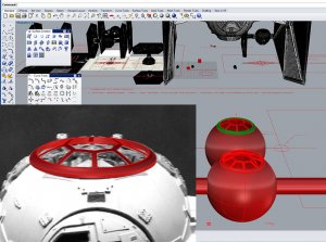

Here is my WIP model of the cokcpit compared to original
and I even started to model some details from kitscans, so If you have some questions, I am able to answer, feel free to ask .

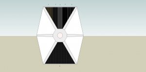

After a couple of lessons sketchup i finaly (4th attempt) have a first drawing of the solar panels from the TIE fighter.
Dimensions 12,2 cm high and 10 cm width
I tryed different colors for the solar plates but I think nr. 6 looks the best.

I have to say that you are off to a great start on this project! You have made very good progress. I would have to agree. I too like Nr. 6. It looks more "realistic" to what solar panels look like on a vehicle like that. I am really looking forward to seeing how this turns out!
KEEP UP THE GREAT WORK!!!

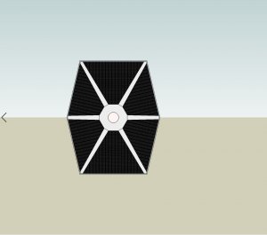

Good evening all,
Tonight we will have a storm comming to our country (Francis).
And here I have an update on my TIE fighter wing

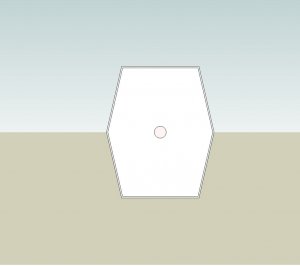

This is the base panel
The solar collector will be fitted on the base panel
The solar support panel will be fitted on the solar collector base panel.
I have to remove some parts to see the solar collector.
And finaly the support arms will be fitted.
The collors of the arms are Metal_Aluminum_Anodized
If I build the wing like this I will get a layerd wing.
Now i'm working on the parts of the energy hub.
