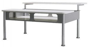

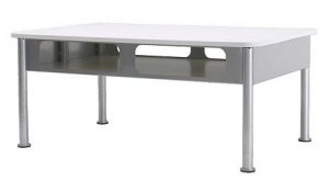

I'm all for supply information and communicating with the designers Fred. :thumb:
Continuous runs, back switching anything goes really. I imagine height may be a problem. I say may because I have a particular table in mind, however, if a plan dictates that the layout is higher than the table, then I guess I'll just have to choose a different table. :D
Again with buildings, this is a scratch project so anything goes. The only criteria it must have is some interesting operating possibilities.
This is the table that I had in mind.
I haven't been to Ikea yet to measure the height, but I don't imagine it will be much over 10cm for this particular table.

The 10cm height limitation is huge. It will basically allow track on a flat base with small loco and small cars, and that's it. No scenery above the train height. No structures or trees going above 10 cm, which is less than 16ft in O scale. You can do some loading platforms and maybe dry washes on a desert or open plains or fields theme. Or a simple track only switching puzzle.
http://www.carendt.us/ is probably your best bet for inspiration and ideas. Good luck!

what about just playing with trains?
No, really, here's what I mean. What if the table were simply a storage space for the componants such as track sections, structures and rolling stock? Looks like each side of the table lifts out to reveal the access inside, correct? So lift out each side and remove the contents, put the top back on and set up a layout. You may need to fabricate clips to fasten at the joints between tracks, or have a steady supply of fresh rail joiners in a container handy. A car routing system like John Allen's tab on car system with a few generic industries such as a freight shed, platform, aggregate transfer (gravel, sand, etc. by hand shovel from hopper or gon to trucks) could provide a switching puzzle scenario.
(Back in high school a buddy and I would dump out a big cardboard box of Atlas (and others, I imagine) snap track and set up something on his laundry room floor then run the trains (tyco, primarily, with some athearn thrown in). Every now and then we'd pick up another box of track from a local yard sale since his folks went out every Saturday morning. We'd stay up late on a Friday night running the trains. The next day we'd rearrange the track and run a while longer. No Kadees, no roadbed, just track on the floor and here's hoping the trains stay on the rails. No switching games, really, just running trains however we wanted.)
You could do something much more refined, I'm sure, but the premise is there. It'd be a chance to exercise some out-of-the-box (or is it 'out-of-the-table'?) creativity. Who knows, perhaps some new timesaver-esque puzzle will emerge. And are you married to On30? What about 009, or HOe?

I see what your saying Galen, but I really want something a bit more permanent than that.
I did think to possibly switching back to 009, but then I decided against it. I'm going to stick with On30 & HO & I figure with being able to use much tighter turns in On30 running critters & shorties.
Yes Fred 10cm is a challenge. Like I said in my previous post, this is the table I had in mind, but the table can be changed. The thing I like about this table is the fact that you can still see through it even with the top closed.

"stick to On30 & HO"?
Why not use shorty HO/OO equipment? The main limiting factor for this layout is HEIGHT, not length or width. 10cm is too short for a one-story house in O scale, but you can easily put an HO or OO single-story structure, including small industries and train stations, plus some short trees, in that height. Using a four-wheeled HO locomotive, like an 0-4-0 steamer or a four-wheel "critter" type switcher, and short European-pattern wagons, you should be able to handle a loop with 25-30cm radius with little trouble. Plus you can use Peco "Setrack" turnouts that are about the shortest switches you can find... then just pull up www.carendt.com for some track plan inspiration.
