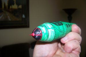

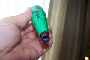

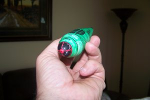

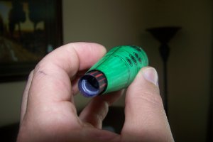

Okay....here a re a few pics of the as yet unfinished but workin' on it Zoot rocket that Mark (the guy in my avatar pic with me) colored. There are still some kinks and areas i am not yet happy with, to work out, and the fins put on...but so far, here is the unfinessed rough of it. The two sections with the words red and yellow on them, are going to be covered over by a "maintenance plate" that will more evenly create a rounded shape, spanning the joint between the two sections and hiding that seam. Im going to just hand draw one and have him color it. I have a couple more from him that I will alter the build process on....modify from mistakes i made on this one.

The front nose glazing section was built as its conical shape, and then i gave a whirl at using the Doming block i got awhile back. It actually worked pretty successfully at doming that front section, but ya gotta really keep ironing and driving those wrinkles out from the back side. In the end, it gave some very tiny minor creases right at the very front edge, but then a paper punch hole piece, given the doming block treatment as well, tidied it up enough. The pics show it more readily than seeing it on the shelf. Learning some new things on these so it's pretty cool. :)

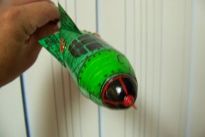

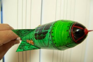

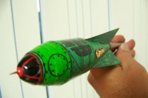

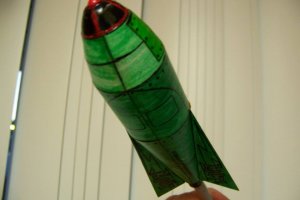

Okay.....sorry for the long pause everyone.....Life just gets tooo busy..Sat home today, and ignored my lawn work and bike ride, just so i could finally get to this....that lawn isn't going anywhere. Okay while its not entirely done, it is by and large for the most part complete. It just needs mounted on a nice wood base..probably with an acrylic rod into the tail pipe, epoxied in. I made a few mods as i said, to try to tie up loose or missing details on the model as it is on the pages. One of those things is the back ends of the fins. I took some different metallic markers and just drew a block of lines then mounted it on cardboard and cut the shapes after figuring out the correct angles etc. A bit fiddly but it worked. the other thing is that plate on the front that i just kind of penciled out and then had colored and added a crappy arrangement of bolts or rivets., to cover the seam and the words red and yellow and help to dome that whole front a little better. Not happy with the way the rivets are drawn(spaced) but too late.
Of course those little orange Michael's jewel thingies aren't paper but i loved the way they contrasted the rest, so I went with them, even though they dont hug the circumference shape so well on the larger ones, but once its mounted and on a shelf, no one will care and Mark gets to show everyone HIS work....HIS Rocket. Lastly i masked the top window area and sprayed it heavy with a gloss coat, as well as dipping the whole forward window dome are in Future to get a nice contrasting glassy sheen and amplify the dome shape to downplay the conical ness of the rest. Okay...enough talk...

The technique you used on that dome would make a great "How to" thread. I love this model!! I love the feel, and the technical prowess which makes this model look so good, yet, deceiving in that it is not an easy build. The nose says it all. Great!!

WOW.....THAnk you BOTH so much... you are BOTH very very kind and very very inspiring and motivating to keep trying new ideas to push my builds and wanting to make each one a bit better...or a LOT better. This one was really fun to build once i got past the hump and grrr spots that nearly ALL projects have somewhere.
The two big grrrrr spots for me on this was actually the nose dome shaping and the little extra plate fore of the top window that I threw together quick. I wish i had taken the time to be a bit more precise and technical as far as the plopping down of the bolt pattern on that part.
I wanted to hide the words and top of the seem where you would view it most, so I should have been cleaner...BUT i DO like how a different shade of green was used to sell the "quick repair from donor rocket" look.
I have 3 more to build. Another from Mark and 2 from Terry.
Pretty much everything was put down with 5 minute epoxy. Because of the way i built the internal bracing and bulkheads, there was not enough room to put in the connecting strips beneath the seams.
each bulkhead has the pinpoint mark where the compass was used to cut them, so i just used that to drill bigger holes through the length of the whole thing, and ran a wood dowel down the middle with a slather of epoxy on the dowel and joined all the sections that way. Once the whole thing was truly cured, I used really thin CA to run into the seams and let it flow into the joins, then just used a very thin black sharpie around the fuselage joints to redraw the lines and cover any CA glue,to make sure no light came through any section joins.
There were a few spots where that was necessary.
