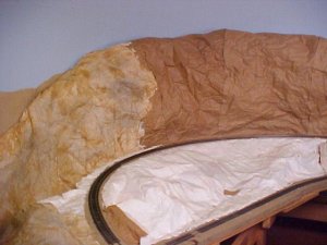

More On Hard Shell
Hi Guys, When it got down to it I never really liked the paper towels dipped in plaster. That was just too time consuming and too messy. Since most of my scenery is going to be mountianous I sorta "changed the rules" on the hard shell scenery just a bit.
First of all I use cardboard strips cut from old boxes. I make the strips 1/2 to 3/4 " wide. I then make a "lattice" out of them for the area to be covered. The strips are fastened to the backdrop and together using a hot glue gun. Use those cheap craft glue sticks they are fine for this...you don't need wood working grade.
Then I take brown paper grocery bags and slit them open...discard the bottom. Cut some pieces large enough to cover the area of the strips and then "crumple" them up real good. Then spread them back out and you've got the texture for a mountain side. If a smoother terrian is needed just keep smoothing the crumpled bags back out until the desired texture is obtained. Then fasten the bag paper to the strips using the hot glue gun. You don't have to get it fasten everywhere just "tack" it down so it stays in place.
Next mix up your plaster as we've already discussed and just paint it on with an ordinary paint brush....2" is a good size. I like to add a second coat for strength once the first one is dry. Then proceed to paint the terrain or cover it as desired.
Here's a pic that sorta illustrates the "steps" Ground cover and scenery hasn't been added yet.

Hi Guys,
thanks for all the inputs. I started yesterday and found that baking soda (didn't know about vnigar till now) was a must. Instead of paper bags I got a roll (500sf; $10) of building paper and cut the strips about 9" wide. Found I needed wooden straps (luckily had a bunch) to hold up the cardboard strips until the hydrocal cured. I've got a long way to go (350sf or so) and like Vic's idea of securing the paper to the strips and applying the hydrocal with a brush. I'll try this next. As everyone says the time consuming job is cleaning the tools between batches.
I'm guessing that the first stage is building the shell & concentrate on the terrain. The second stage will be to add the color to the hydrocal and define the details (rocks, portals, hills, streams, waterfalls etc.) After the shell coat wouldn't it be easier to switch to plaster for the finish coats. Plaster could be prepared in larger batches, takes paint & stain better while the hydorcal provied the strength for the shell?
Well, I'm off to mix a few batches. Take care, Jim
