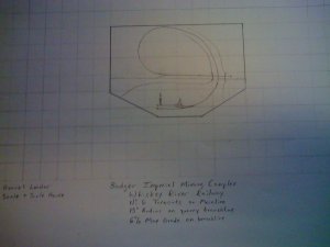

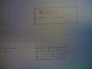

Doodles
Hello everyone,
After finding out that we don't have a scanner that works on our network I had to take pictures of my doodles with my cell phone. The first picture is of the town of Whiskey River. I have a #8 or #10 (forgot which) curved turnout that'll be used right after the bridge. That industry is the lead and zinc smelter, the spur closest to the river is the inbound cars (hoppers coming from the mines) and the other is the team track/outbound (boxcars shipping out products and shipping and receiving off the team track). Both tracks should handle two or three 40' cars. Bill has molds from his ore smelter that looks very similar to ones found in southern WI, so hopefully they'll fit good. The other picture is of the quarry which I had to draw the track plan first to make sure it'd fit on a decent sized piece of real estate. This plan is a combination of a quarry I found with the prototype in (I think) Conneticut and Bernard Junk's Junk Sand and Gravel micro layout (http://www.carendt.com/microplans/pages/industrial/mining/junk1.gif). In my original concept which I drew up on Microsoft Paint the lead track didn't go over the track going down into the quarry, but I had to readjust it for the length of the longest loco that could access the quarry (#10, a two truck Heisler plus a permanently coupled caboose) and four hoppers. In the bottom of the quarry I plan to use a stub switch to service both the loading track and the empty track, and the loading track might have a scale house (not sure if I want that in the bottom of the quarry or somewhere else near the quarry, I'll have to do more research to see if that'd be a logical idea). The quarry should be interesting to build and operate as you have to run backwards into the siding, down a 4 or 6% grade and around a 15" radius curve, switch cars from there, return to the top track and either the quarry switcher will take the cars to the next town or have the local pick them up.
Other module plans are brewing, but after I get another module built I plan to make a "jumper" section to create distance. The jumper is just a two by four with track on it that can run between the modules, no scenery but maybe painted in natural colors. For now I'm trying to keep things portable and for now will have to set up the modules either in my living room or the backyard until I have a home for the modules.
In other news, I want to buy decals for my rolling stock. What company does good work for a good price? I'm looking to decal about 40 or so cars, about 2/3 of them need the railroad's herald.
Tyler

hi Tyler,
Thanks for sending out the pictures. I think modules are a great idea. If I were starting over in HO or an On30 layout I would go the modular route. You can get each module completed to a high degree of finish and feel like you are getting somewhere. And as you mention they allow tremendous flexibility with moves and changes in homes.
Stan Cedarleaf is a really nice guy that can help you with custom decals. Here is his site http://gold.mylargescale.com/StanCedarleaf/WebPageDecals/CustomDecalsx.html
He did all my decals for the Little River Shay and they turned out nice. He also pesonalized the work by getting very exacting measurements from me and looking at prototype pictures. I will be probably talking with him again soon about making some decals for teh logging flat cars Iam working on for the LRRR.
Stay safe and warm there in crazy ole Afghanistan. We are all looking forward to your return!!
Doc Tom

Modules make a lot of sense without a permanent home. I started with the notorious Bumpass modules, and then built the Gizzard as a module, when I got my current attic, I built permanent, but Crooked creek, Ridgemont, Stateline, and Harlow were all built in sections, and could theoretically be re used , although Crooked Creek is the only section I am 100% happy with.
