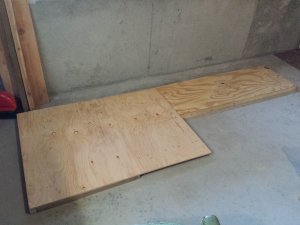

Now something that I've been wanting to do for a while is working on the layout for my mythical land. I've had one module made since 2010 but have altered what I want in a layout so many times that plans have been just that. However I made (this past Friday) another module for the pre-made to be part of Merrick yard. I don't plan on building the whole railroad right now as I don't have the space for it. Right now Merrick yard consists of two modules, one 18"x 50" and one 3' x 4'. The corner closest to the long module will be cut on an angle to give reaching space in the yard and/or station tracks. As of now I don't have a track plan specifically for the two modules but will see how close my plans I have will fit the allotted space.20151207_100253.jpg

Now something that I've been wanting to do for a while is working on the layout for my mythical land. I've had one module made since 2010 but have altered what I want in a layout so many times that plans have been just that. However I made (this past Friday) another module for the pre-made to be part of Merrick yard. I don't plan on building the whole railroad right now as I don't have the space for it. Right now Merrick yard consists of two modules, one 18"x 50" and one 3' x 4'. The corner closest to the long module will be cut on an angle to give reaching space in the yard and/or station tracks. As of now I don't have a track plan specifically for the two modules but will see how close my plans I have will fit the allotted space.View attachment 147457
The caboose turned out real nice. I like the color and the decals are perfect.
Also the modules look good. That is real sensible way to get a layout started. I am about finished with the Haitian Sugar Hauler and will begin next on a module of a 1910 backwoods logger with wood fired shay and climax and link and pin couplers. This will again be in On30 like the sugar train.

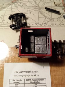

I got a little more done on C8 today, I tossed some #158's on both ends of the car and added some weight.20151207_195038.jpgLike some other model railroaders I use self-adhesive auto tire weights. These are the 1/2 oz ones that I acquired while in the army and work well for my application. Normally these wouldn't fit in the car body as they are so I took my bench vise and squished them into the size I needed. I used the same technique for adding weight to my flatcars. The caboose rolls a little better now with more weight in it and the contacts taken out but it still needs something done to roll better. I'll have to investigate further.

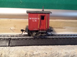

Caboose C8 is complete! I threw the grab irons on and threw another wash of grimy black on the body to show many years of work going down to the quarry. I also noticed that the ex-Shay truck the car sits on isn't square, so when I tightened the truck sideframes together the wheels wouldn't spin freely. So I have the screw kinda loose so the wheels spin with a little graphite in the bushing for lube.20151209_152027.jpg

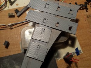

Wasting no time I hopped on throwing the first coat of black paint on heavy duty flatcar #107, and while that dries I started into C3. Caboose C3 is an old Red Ball kit that somebody modernized the cupola by removing the fancy circular window that sat center of the cupola lengthwise. It still retains its three side windows on the cupola.
The biggest issue I previously had was tearing the sucker apart. Whoever built it made it with some kind of rubbery yet extremely tacky glue that held up well over time. A warm screwdriver tip helped loosen the glue enough for me to pry my way into the car, finally breaking it down into it base components. 20151209_203116.jpg

Wow, that is beautiful!! I would love to see the layout moving. I use motorcycle weights, they are a bit smaller and easier to trim, and are self adhesive. I am an old fart who still changes his own motorcycle wheels and spin balances the. I get no vibration, even as 120 mph. :)

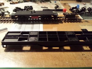

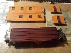

Caboose C3 and HD flatcar #107 got a lot of work done today. I'm not sure what kind of paint Bachmann used back in the day but it took three coats of black to cover up the red. Last night prior to the paint job today I found a flaw before pre-paint assembly, the center axle on the three axle truck rubbed badly on the bolster. Nothing that a half hour of filing couldn't handle. Alas, all bugs are worked out with it and just needs decals and weathering to be complete. 20151210_174845.jpg
While I disassembled C3 to strip paint I noticed that I have one issue on my one end casting. There is a small hole in it thanks to zamac poisoning. Oh the joys of collecting older pot metal cast models. It does look better in primer for now compared to the paint brushed 1950-1960's paint job. 20151210_174935.jpg20151210_174944.jpg
