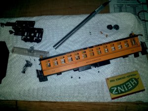

My first attempt of casting turned out to be a failure. I decided to experiment instead of using the kit supplied cast material, the substitute being gasket RTV. Needless to say it just clung to the plastic door I tried to make a copy of. Lesson learned there.

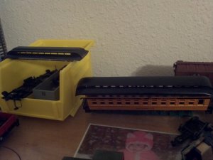

The wonderful old eBay has supplied me with three more passenger cars. They are truly relics, as a little research showed they were old Selley cars. In this lot two were unbuilt and one was mostly assembled, I'm thinking one will remain a master for casting parts. They are neat looking cars and should paint up nicely in WRRy colors. Stay tuned for pics, and Bill and Tom (and whoever else) should check out trainlife.com for out of print magazines and to connect with other railheads.

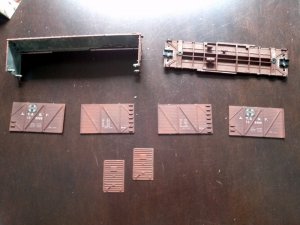

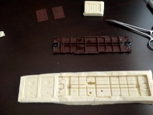

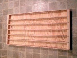

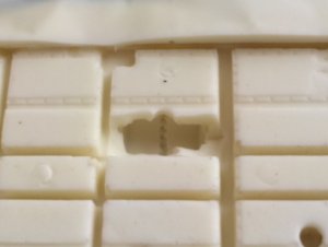

I've been slacking at updating in the WRRy world. To be honest, not much has happened. I did bust out my casting kit in early July and attempted to cast new parts using a old Roundhouse outside braced cast metal boxcar kit that was partly disassembled. Soon after making the molds I found out two things: tinfoil is a decent alternative to building boxes for your molds and either my kitchen table is not balanced right or the floor is off kilter (I'm guessing the latter). The parts came out well detailed but heavy on one side due to the uneven surface the mold laid on. It was a good learning experience, and now I know what not to do.

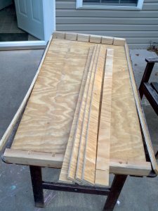

Lately I've rekindled one of my other projects. I wanted to have a display shelf made back in May so I cut up the wood. Just yesterday I started sanding down everything and getting it ready for stain. I'm going to try to stain it the same colors as the wood stuff in our bedroom as that's where it'll go for now.
Attached are a few pics of what I've done so far, both in the casting and the woodworking world.

Very good start on the castings. I like the display case you are building for your fleet. Looks good.

Thanks Doc Tom, it took me a while to make time but I'm finally getting back into finishing projects before the weather is less in my favor. The shelf is almost done now, it just needs a few nails in the shelves to hold the weight of cars or locomotives and to be stained then clear coated in polyurethane. Since all the wood was cut in late May and it's almost the end of August, some of the wood has warped leaving a few gaps. When the day comes that I get a dedicated train room or area, this shelf will probably be for stuff that doesn't have boxes or stuff I don't have room on the layout for but might use since I didn't design this one with a door of some type.

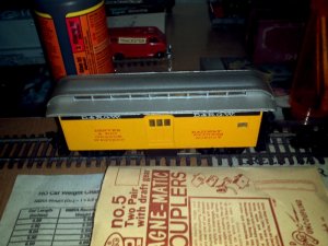

Less than a week ago I found the baggage car I've been looking for. A longer time ago I did find a similar one on eBay, bid on it and won it, but then received a message from the seller saying that the baggage car had been sold already and somehow it got relisted. I've had that issue happen before with selling stuff so I knew where he was coming from. This time around I scooped it up and for a awesome price too, all thanks to his lack of spell check (Bill, take notes on this). I'm not sure what a baggae car is, but that's what I bought for $3 plus another $3 on shipping it to the WRRy shops. All in all I now have my 34' BAGGAGE car that the crews have yearned for.

Bill Nelson
Tyler, that is an MDC shorty overton. MDc made a combine, coach, baggage car and a observation. They are basically a freelanced car, designed to be happy with extra tight radius's; but they were loosely based on Sierra Railway Prototypes. The Sierra Railway's Angels Camp branch had some tight curves and a switchback that made traditional coaches impractical, so the Sierra Railway had a shorter coach and combine built for that branch.
I have one each of the baggage, combine and observation, and three coaches, and that makes up my HO mainline passenger train, (except the observation, which is at the club.) My branch line passenger trains consist of a Labelle coach an combine shortened, but not that short, and a combine caboose kitbashed from a Manuta 1860's combine.
I have converted lots of the MDC shorty overtons to HON3 as well

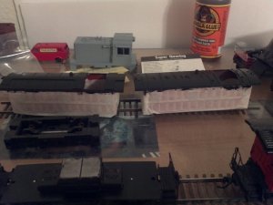

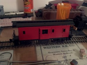

Low and behold, this day the seventh of October in the year of our Lord 2012, I got a break from the proverbial "Honey-do" list and the repairs on my truck. Work was re-initiated on the Whiskey River Railway fleet, since I got a chance to get to the Tennessee Central Railway Museum's hobby store yesterday. Paint, another pair of Kadee's arch bar caboose trucks and some Squadron putty were purchased. But enough of the nonsense...
The company's twin cabooses, C5 and C6, have finally gotten their full coat of red paint soon to be followed by a black roof. C2, the railroad's only bay window caboose, finally got it's window castings painted and are now installed on the car. Soon enough, all three cars will have a gloss coat applied, followed by decals, a dull coat and then final details.

Your cabeese are turning out very nicely. I like the red color. Too bad we don't see cabeese on our modern prototype trains anymore.

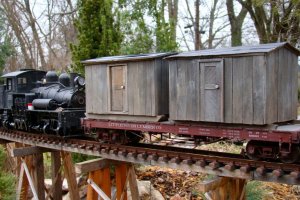

I need to check out the Tennessee Central museum and hobby shop some time. You have mentioned it several times and it has been probably 10 or more years since I last went by.
I like your varnish project and I too have enjoyed using old prototype pictures to do some modeling.

Looking good! I like the Cabeese. If I do my RR's rebuild, my cabeese will need some attention. As it is I have been using combines in place of cabeese perhaps 70% of the time probably more considering the two of my cabeese that get used the most are combine cabooses.
