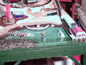

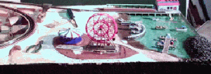

The Tide comes in to the Bay
A 2" x 10" section of our first section, although happy with the outcome, the Epoxy Casting Resin was an expensive water for the reasonably large area.
2kg @ $46:50p/kg, It was very slow curing, and not suitable for wave forming.
The local bay that i based this scene on, is frequenty glass smooth, so therefore this is not out of place. I can use the lack of air, as an excuse for the Yachts never moving.

Hi Damien. It looks great. I does only need to be just covered to look like water. On my layout it's only about 1mm or so thick, but it don't run to the edge like yours. The way you did it gives it depth! and makes it look fantastic. :thumb: Fred

:wave: Hi Jodam, that's a great looking scene. Did you make the pour for the water all at once, that will cause it to dry very very slowly and sometimes causes cracks. It is recommended to make small pours and let it dry and then pour again till you get the depth you want. On the last pour you can get the wave effect in several ways, with a hair dryer, or wait till it is almost dry and pick at it, which is both time consuming. I like to use the WS water effects as you can move it to what ever you like as soon as you use it and when it dries it is totally clear, dry brush the white caps and your done. Hope this helps some. :rolleyes: Jim
Hi Jim,
I chose the slow cure Epoxy resin because it was clear, The quick cure has a yellow/brown hue when cured. & Epoxy has little or no odour.
"Quote from data sheet :- Epoxy Cast 306 is a low viscosity cycloaliphatic epoxy resin system, with a long pot life and extended working time.
With epoxies the larger the mass the shorter the pot life, only mix the amount of product that can be used within the pot life. end quote."
I was advised that pots up to 5kg or 1 gallon possible as no heat generated during cure, as there is with polyester resins.
The bay took 2kg in two pours. I attempted wave ripples when as cure progressed, but it flowed back to smooth, right up until solid, my first layer had some interesting effects that looked like water currents. I've since found out they were caused by improper A, b Mix, the second pour had no irregularities when cured.
Thanks for your comments though.
