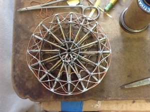

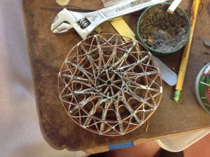

My most recent work has been scratcbuilding the wheels out of brass and copper, and the wheel houses out of brass (so far at least). They are going to need a lot of decoration.

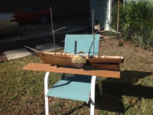

The deck house so far is mocked up out of cardboard. It will house the servos, so I want to get those figured out before I build the deck house. I have no idea what I'm doing with RC . My only other effort with RC was a rowing mechanism for a pseudo Roman bireme. That was unsuccessful, as the mechanism, electronics, and battery were too heavy , and put the oar ports too close to the waterline.image.jpeg

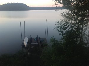

If successful , will be sailing off this dock. The 17 foot grumound canoe is the recovery vehicle.

The inside of the d

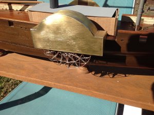

Starboard wheel, the outside will have sone fancies inside the center ring , mostly futile as the wheelhouse covers it up, but I know it is there.image.jpeghere is the wheel house. I may solver on brass or copper decorations later , or laminate wood that was either carved or burnt. I'll figure that out later. The cardboard deckhouse and plastic funnel are stand ins.

If you look back on the picture of our dock, I keep a 17 ft. Aluminum canoe , and some cheap paddles and life vests on the dock. The canoe's combination lock is ornery, so I will probably unlock the canoe before launching the Pelican.

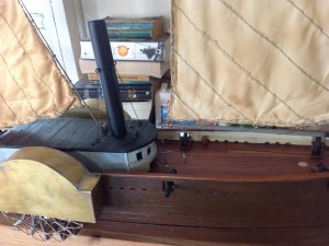

It's radio gear is all installed and working. Not as much travel in the sail control as I'd like, but the 6v 30 rpm gear reduction motor I have installed is quiet . And the speed of the paddle wheel is spot on.
I have made one sail. My sewing got better as I worked on it. So I believe by the time I make the other five sails, (3 jibs and an aft sail on the fore mast; and one jib and an aft sail on the aft mast.): I will be considerably better at sewing, and may want to re do the one I have completed so far.
We have a high thread count cotton sheet that developed a rip, and that provides the sail cloth. The one sail I have finished I soaked in tea to get a more canvass like
color.
Still not figured out what I'm going to do about decorating the wheel houses. One possibility would be to solder some copper wire to them to create some designs. Or sheath them in wood. And use a wood burner to create a design in releifimage.jpeg.

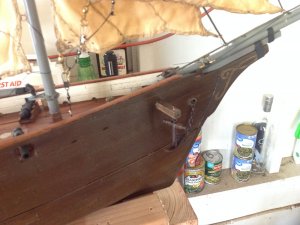

Since my last Post ; I have sewn sails out of old cotton bed sheet, made a dock stand that will accommodate the Removable sailing keel, scratch built anchors, and scratch built cannon.
It is ready for lake trials when I can get back to the lake. Possibly as soon as next week, as we are planning to go back to to Tennessee to check the properties, and bring some stuff to Texas , before we make our late spring transition To TN.
The guns in the stern.
The guns in the bow
THe starboard anchor.
A wire sticking out the funnel is an aentenna . As is another sticking out of the front of the deck house.
I'll n

keep a 17 foot canoe on the dock, will have it unlocked an in the water , with paddles and live vests on board before I float the Pelican. the lower section off the Pelican's hull is full of chunks of styrofoam, , and all but the sail control servo is above the deck

The pelican was unstable, and it's displacement would not support a heavier keel, so it is on the mantle at the lake house.
