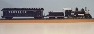

Been thinking of altering my passenger cars (Bachmann Jackson&Sharp's) to look more like the SR&RL cars.I only have to stretch them 10'.
Catt,
I've had four of the Bachmann passenger cars apart, to cut off the coupler pad, so the coupler could be raised. To extend these cars, we have to cut: the sides; the roof; the floor; and the interior floor with the seats. then, the undercarriage has to be rebuilt, and new truss rods installed.
I'm thinking the interior lighting can be done with multiple 1.5V bulbs, and an LM317 variable power supply chip.
In order to get the floor separated from the sides, the wiring for the existing interior lighting has to be cut.

On30 combine
I had a chance to do some cutting, and fitting. This still needs some finish work, and painting and lettering, but this is what the Bachmann On30 combine looks like 10'...four windows...longer.
At this length, it will no longer handle 18" radius curves, but I think the addition of the Walthers coupler swing adapters might make that radius possible. The picture shows the combine, and one of the original length coaches.

I still think I'll do a set Pete.It sure does have that eastern two footer look to it.:D

Extended Combine...
Hey!
That's very cool!!!
When most folks are chopping their Coaches and Combines to half the length, you're extending yours....
Way to go! Swimming against the current....
Looks great with the larger motive power too...
You could take up a collection of all the sections that other folks are chopping out of their B-Mann coaches and combines to add to your oun....
