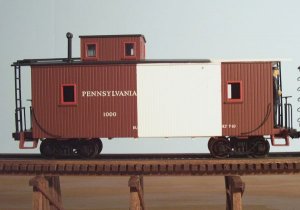

I currently have several projects going: The On30 2-8-2; Stretching the Bachmann On30 caboose from 20' to 28';and a 16" X 4' On30 diorama. There's also the intention to build an On30 2-6-6-2, and the 2' X12' On30 lumber switchback.

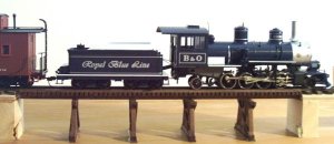

Pictures, we don't need no stinking pictures:D :D :D
Only one picture, it was posted on Catt's "engine house" thread.
I'm waiting for Athearn to send a new drive gear for the Genesis 2-8-2 chassis, before any more work on the On30 2-8-2. I'll post the caboose when the construction is done, or maybe a shot in primer.
There's a trestle on the diorama, so maybe I'll be far enough along for the "locos on bridges" contest.
