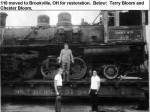

At least it is not to the point of decrepit as in the photo below when it was found abandoned and headed up north for restoration.
Tom:cry:

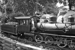

Awesome, those black and white pictures intermingled with those of your model really are a great juxtaposition! :)
Doctor G
Sep 2, 2008
1,415
295
Clarksville, Tennessee
Thanks Zathros. I have really enjoyed "researching" the Little River RR. I found most of the prototype pictures on the Little River RR museum website.
