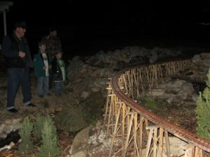

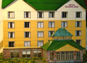

Museum model
Well I completed this model of the Hilton Garden Inn for the Clarksville Montgomery County museum Lionel train layout. After a small ceremony at the museum a lot of the museum crew came over to run a train at night on the Little River Railroad.
Kids are a big part of the Lionel layout and a couple came to have fun running a train outdoors on a winter's eve.
Doc Tom

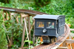

Spring Time
We have Spring bustin' out here in the Southern Appalachians . The LRRR took out combine 310 for a little trip to Tremont.
Doc Tom and the Little River Rail Road in Tennessee:wave:
