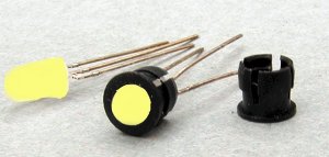

Hi msh, my LED’s came with a plastic holder, I inserted these into the holes first (Tight fit) then plugged the LED’s into it. My thoughts are you haven’t got the holders. Go back to the place you bought the LED’s from and ask for them. Many different sizes of LED’s and holders so be careful.
I have attached a photo to show you.
Shamus

Oh, shamus.... that's a really great solution and certainly as it should be. (nice picture too - did you take that just for ME??)
I bought the LEDs at 1stplacehobbies (miniatronics 12-250-05) and the packages contained only the LEDs and one resistor each. I've run a search on their site and find no record of a holder. Argh.
I suppose I could check with the LHS, but I'd feel pretty silly since I didn't buy the LEDs there. I shop primarily on-line.
So, I hope we can come up with another alternative as a fall back.
Hi Mike,
Glue a piece of 0.020" styrene covering the back of the hole (or whatever other material you have at hand). Then drill holes in it for the leads to poke through. Install the LED's from the front with a little CA before soldering the wires.
The snap-in holders or a rubber grommet are the best way if available. They trim out the holes nicely as well as secure the LED with no adhesive.

Msh, If you let me know the size of your LED's, I can get the holders for you, and yes I did take the photo just to show you. You really would be better off using them as they also look nice in the panel.

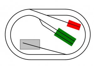

Here's a Peek
Here's the control panel as it sits right now - unwired. Oh, that's going to be FUN!

Sure marty - all just need is directions, a plane ticket, good food, a few martinis and a bed. ... oh, and my wife's okay. ;)
Tell you what I will do though... I'll make you a nice graphic you can stick between some plexiglass like shamus and I have done. You provide me with a drawing or other accurate representation of the "flattened" layout (unless it's tiny like mine and the literal layout will work) and I'll get it into Visio, create a version for your approval, and get it on to paper or into a format you can print!
