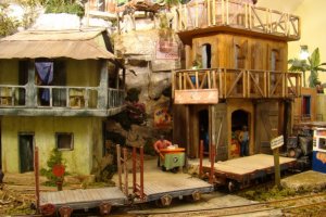

Why is everything so heavily weathered and faded except the cane cars? :confused:
Very observant M.Man!!! I haven't figured out what colors I want to paint the cane dump cars yet. Lets just say they are new arrivals from the mainland USA and have not gotten painted or used much.
Thanks for looking. Doc Tom:cool:

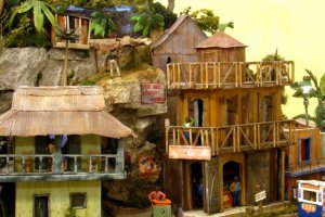

Another building for Port au Prince Haiti
Hello,
I have been slowly working along on the Haiti Sugar micro. Here is the latest building for very congested Port au Prince Haiti.
THis is a background building of a corrugated metal wharehouse. It is right behind the Le Petit Mec store.
It was constructed using foam core board and covered with Paper Creeks printed metal siding. Hope you like it.
Doc T:wave:om

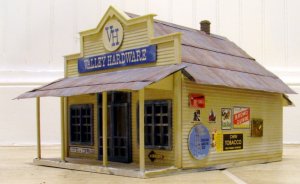

Hi Gus,
That is a neat product made by Paper Creek Models http://www.papercreek.com/ It is actual paper printed with the help of a computer. You cut strips of this printed paper and glue to foam core board. At a distance it looks like actual rusting corrugated metal. For the foreground buildings I made individual corrugated sheets from aluminum foil pressed on a jig with ridges.
Here is another model I did for the local Lionel Layout in O scale for our local museum. It too uses Paper Creek's printed corrugated metal.
Doc Tom:wave:

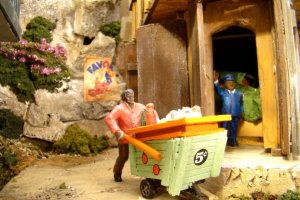

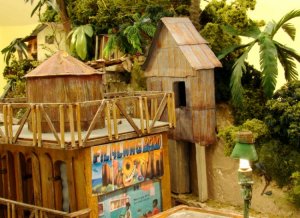

Cold drinks in Hot Port au Prince
Here is the latest model creation on the On30 sugar hauler set in Haiti in the 1920's.
Haiti is a very hot tropical country in the Caribbean. A bustling business sprang up on the streets of Port au Prince to sell shaved ice with syrup flavoring to help keep people a little cool. These "fresco" sellers are all over the place.
I scratchbuilt this very little model and the fresco seller is "hawking" his refreshing drinks in the street scene slowly developing outside the Le Petit Mec.
I have included some "prototype shots" so you can see what I was trying to model.
Doc Tom

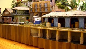

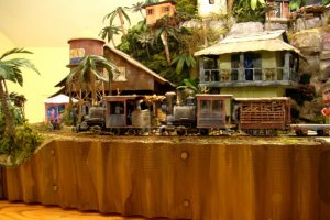

A fascia comes to the micro layout
Hi All,
I was able to get a little more work done on my micro layout.
This is a very portable micro layout and I would like to have it travel about when finished....including perhaps the kids in Haiti.
So one of the things the micro needed was a fascia to hide all that pink foam used in its construction.
Since this is a "pioneer" layout for me in many ways I decided to forgo the usual masonite fascia and make this one look like corrugated metal to accent all the rusted corrugated metal on the buildings on the layout.
Real corrugated metal would be too heavy so I scoured the internet looking for plastic substitutes. What I found was a green corrugated garden edging roll for about 5 dollars.
It was painted with a gray primer and then the same craft paint acrylics I used on the buildings were used to get the streaky rust effect.
The light weight rusted corrugated "metal"/plastic was affixed to the layout using construction adhesive pinned with real nails in to the foam.
Here are some pictures of the end results. Let me know what you think.

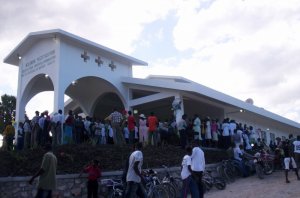

Haiti Earth Quake 1-12-2010
Hey Doc G In light of whats Happened in Haiti I hope everyone of your friends is ok and that you weren't there when it happened.
Thanks S class
Thank you for your thoughts prayers and concerns. It is very hard to see the destruction and loss of life in a country I love so much.
Our Visitation Hospital (www.visitationhospital.org) is 40 miles to the West and was hit by the earthquake but is still standing and functioning. Luckily we had used reinforced concrete when we built it 3 years ago.
Our St Jules Clinic in Northern Haiti has done well as it was far removed from the epicenter. We are gearing up at both clinics to begin receiving casualties as survivors stream out of Port au Prince.
Please keep Haiti in your prayers.
