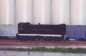

Its been a week since my last post and I can tell you that my switcher continues to GLIDE down the rails and slip though turnouts without hesitation at wonderfully slow speeds! I am so tempted to oil up the rest of the layout! But, I will wait for another week just to see if any problems develop with the experiment.
My intrepid switcher happily waiting for another slow speed assignment at Hudson Cement Co.
