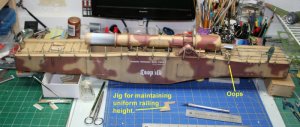

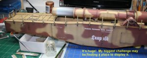

Almost Done!!
Good grief! Did I really start this thread and this project five years ago?

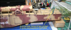

When I first built the two side trusses that support the gun, I built the trusses completely--inside and outside skins--then tried to join them. Of course, they weren't entirely straight, so I ended up with a sort of hourglass shape, subtle but enough to be a problem. I set the project aside for "a few weeks." About a month ago, I decided I had to finish it.
I carefully peeled off the outer skin of each truss, laminated all of the cross member parts to 1/16" basswood sheet (Thank heaven for scanners), joined the two trusses, then reattached the outer skin. Glory-osky! It's straight. Adding the decking and end pieces was straightforward with only a few fit issues, easily corrected. The assembly drawings are a bit sparse here but I think I got it all correct. The photos help.
I wanted the railings sturdy so I scanned and stretched the uprights and wrapped them around toothpicks. For the horizontal railings, I'll use plastic or aluminum rod painted to match the decking. The result is will be a bit larger than scale but will hold up better when I transport and exhibit the model, and it and doesn't look out of place.
The railings and the four ladders are fussy and tedious and I'm working on a couple other small projects to break the monotony.
The last assembly will be the rest of the gun barrel. That should be easy.
I plan to mount the whole thing on a 4-foot pre-stained shelf board from Home Depot. No rails or ties, for now. I'll cut two grooves in the shelf for the wheel flanges and fasten the rail carriages down with long twist ties.
My next post will be photos of the finished project...sometime before 2016.:p
