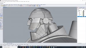

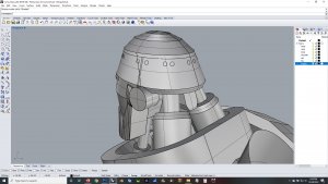

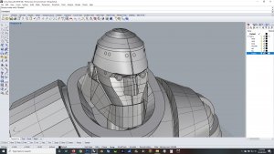

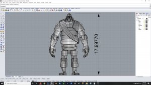

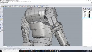

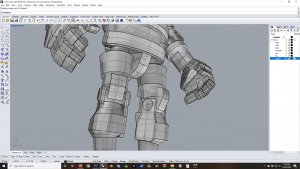

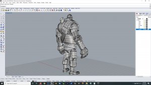

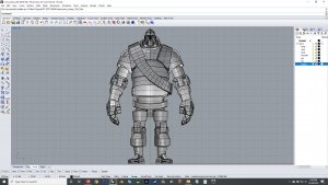

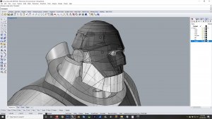

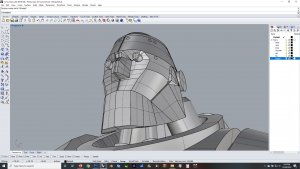

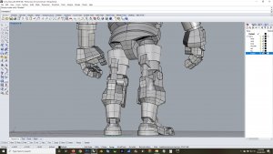

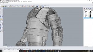

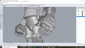

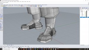

It is my most favorite character in TH2 next to Pyro. I don't know what scale it is. But right now, it is a lot bigger than my plastic 1/6 Three A Heavy action figure. Most of the parts are rough out, but the hip joints. I am planning to make it completely poseable. And the gun too, I still need to do. I got a long way to go with this guy.
11,610
12,350
I'm blown away already..! Always keep in mind the thickness of the paper when you make the joints. The connector tubes must be a tad smaller than the holes they are put through to make sure the part is moving. A rough estimate would be a decrease of the diameter of 0.4 mm (depending of the kind of paper used; at least that was what worked best when I built my 1/6 scale Crichton ). You can always stiffen up a loose joint by wrapping some layers of tissue paper around the tube.
