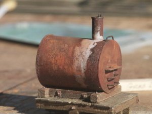

Originally posted by Russ Bellinis
If you use denatured alcohol to thin any paint for spraying, be sure to let the paint on the model dry thoroughly before using Dull Coat. If there is any alcohol left that has not evaporated out of the finish, it will turn Dull Coat milky.
But there can be times when the reaction between Dull-Cote and alcohol can be put to good use. In the photo below, I deliberately dribbled alcohol on the tank after spraying it a few minutes earlier with Dull-Cote. I wanted the appearance of lime and hard water deposits on a rusty old water tank. This was the initial result:
