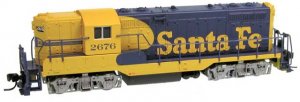

I need your guys expertise on this one :D
I am currently building an N scale Timesaver module for my layout and I would like som info on what type of engines I can use as switchers.
I know of all the Alcos engines, and the SW1200 type engines.
But what can I use more than those?
Can I use a GP7 or an GP9 as an switch engine?
this is an Atlas GP-9 Phase 2... :p

Most railroads use an older model loco to local switch with than what they use for mainline service. This gets the last of the life out of the old units and keep them close to home so when they give up the ghost it's not far to the scrapyard. LOL Bigger yards will have special engines like SW1500s to build trains, but you rarely see them out of the yard limit. Now back to John Allen's Timesaver, it's an industrial switching puzzle, so you prob wouldn't see SW1500s. You would see the local units doing this work. So depending on the era you model you will be using different locos, say 1970's you would see CF7, GP7,9, stuff like that. Today you would see GP38-2, sd40, stuff like that. Tommorow you will see sd50, and dash 8s. That help? Of course there are exceptions, this is just a simple rule of thumb answer. FRED

Sure,you can use any type of a geep unit from a GP7 to a GP60..After all the GP is a general service unit. Of course you could use a Alco RS2,3 or 11 as well.
Many of todays short lines uses Geeps as their only motive power.
