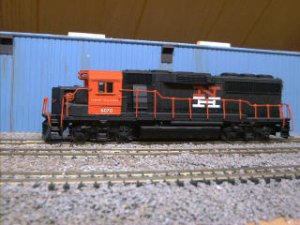

Can't help you on the NS specific details. But here's some numbers I used when I super detailed my GP-60.
Snow Plow:Metal Minatures.....PL-59, EMD Plow
Coupler Lift Bars..Detail Asscociates........SY2211
Grab Irons..........Deatail Asscociates.......SY2202
A little hint: If replacing the lift rings, go with the metal ones from Details West. I tried the plastic ones and they seemed to brake if you just sneeze. I finally replaced them with metal ones.
