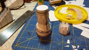

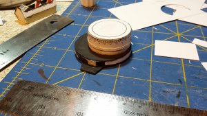

I found that you really begin assembly with the engine. Some designer in human future history created the standard construct template for an engine then decided to bolt on wings, weapons, and a cockpit (in that order).

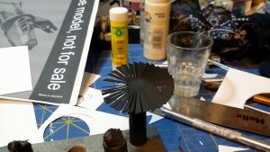

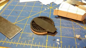

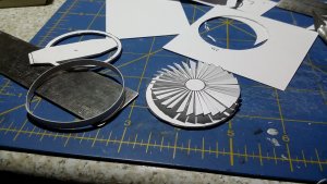

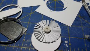

I was happy with my turbine blades, I hope they hold out when I paint the rest of the Vulture
Priming with flat black here. What the paint brush misses will be dark, and in shadow!
Lots of grebles to go with the rivets!

Very nice looking jet engine blades~~ :)

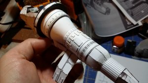

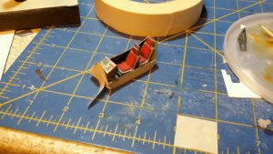

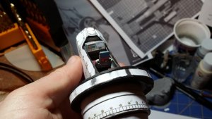

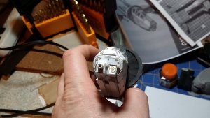

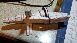

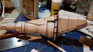

Got some progress in yesterday and today. I assembled the engine and cockpit, and found a disturbing gap. It only disturbs me because I know I can't get spray paint, or a brush, down into that area. Time to make a body panel!
I did enjoy the ability to greble with loads of rivets using the glue drop method!

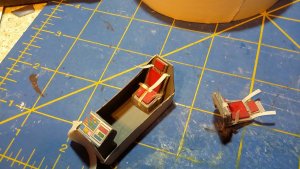

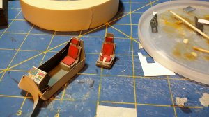

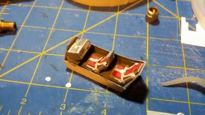

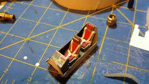

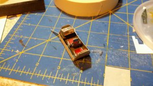

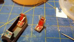

I have to show off the nose bolter and sensors and cockpit. Whatever else happens with this model, these came out great. If I get too angry with the model, I can at least hang on to these!
Some more engine and cockpit grebles for you! Thinking about taking some wire to make engine piping...

Have to add, I want to sit in that cockpit!! I really enjoy models that have cockpits. I was a pilot of small aircraft for a while, and to me, cockpits, especially detailed, really add to the genuine realism of a model. ;)

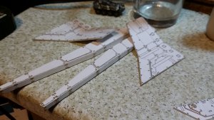

I do have some progress to report. I got an extra day to work on the project (due work being evacuated...).

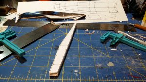

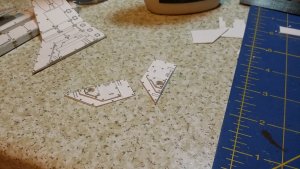

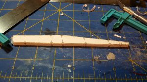

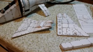

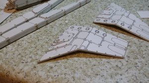

Mostly I have spent the last week or so workign on the wings and the tandom pylons the will mount to along with the tail assembly. Lots of rivets to dot along the assembly, along with lamniation. I made the wings 4 pages thick. All panels glued on top are at least two pages each. I will get a layer count at the wing root, but it around 8 to 10 pages at the wing roots.

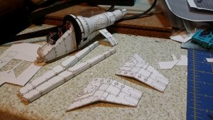

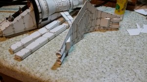

Got the wings (mostly) done. Enough to get them ready for assembly onto the pylons. Got the horizontal stablilzer that runs between the pylons ready. I'll save the tricky assembly of the pylons, wings, and horizontal stabilizer for tomorrow when I'm fresh.

These wings look great and solid. Question: Why do you have to laminate with several sheets instead of using thicker cardboard? Is it a special trick, are they more solid?
Reactions: Sudsy
12,568
8,060
Personally, I think over time the piece holds up better. Less moisture absorption, and you can make it to the thickness that's appropriate, and control the shape better. I'm a big fan of laminating. ;)

Most if not all THICK stuff is a laminate ( soft) of several layers ( mat board for instance ) only built up to provide a ground for the colored layer or a hard rolled clay surface ( illustration board for instance) and to provide a stiffer surface. In all cases, the laminated board will tend to de-laminate along all the edges if worked. It will also de-laminate when painted. Several thinner layers laminated with appropriate glue will be N x's stronger. Just search for Lacquered Armor ( note they did not make an authentic set of Lacquered Armor in this Myth-Buster story, which will not be bothered by getting wet.

Zathros and Gandolf50 both have great points. Truth is for me, I printed on one type, and found laminating with like materials more conveinient, and less worrysome. I have no issues using cereal box, but sanding the the glossy print surface is time consuming but necessary for the best glue/paint surface. I tend to save such materials for interior reenforcment of box structures (like the inside of the BMP, shameless plug of my other thread here).
