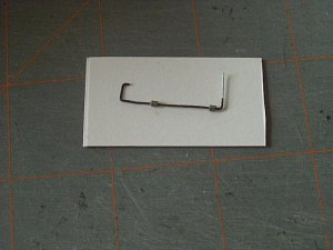

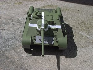

An update of the very little progress I've made! :sad: Finally finshed one side of the road wheels. Made a few mistakes due to the drawings not being very clear - as I was cutting parts for the wheels, I realized that I was going to have a lot of parts left over. After studing the drawing for what seemed like hours, I realized my mistake... Took apart what I could, living with what could not (fortunately, you can't see these because it is on the inside) and rebuilt... Next step: Learn Polish... :grin:
Oh yeah, I accidentally drop the model also - wheels rolling all over the floor, rather humerous once I stopped cursing! :rofl:
Top view of some progress on the little stuff
Off tomorrow, so hope I can make some serious progress (not to much more to go!).

Let's see if I can get this to make some sense - the road wheel diagrams made it seem that one part was used for front part of the wheel and another for the rear part. But what it really meant is that the parts were layered for both sides... After building a wheel or two, I realized I was going to have many parts left over (about ten each - hmmm just the number of road wheels! that's when the light went off). After viewing the drawing a million times, I realized how it was supposed to be built. That made me review a couple of other drawings that I misintrepreted... Answer's limited drawings are not very clear. I think it will be a while before I try another Answer kit...

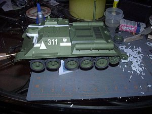

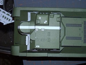

Well, Jim got me off my a** and take some pictures.... I really am not too far from finishing, so I'll post these and hopefully in the next couple of days be able to post the final build pictures.

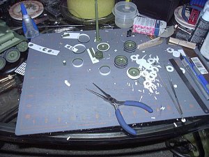

First off, the mess I call a work station :eek:ops: - probably a good reason why I can't seem to make much progress!
Ok, to the real stuff. Some little stuff:
And mounted:
Side view

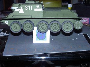

Chris - If you look at the two road wheels on the right, the one on the far right there is only one layer of the inner rim. If you look at the one next to it, you can see it has two layers. That is one of the problems (in my previous post) that I tried to explain! :confused:

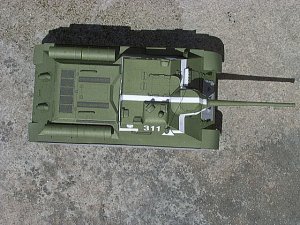

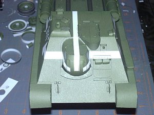

Front view
The barrel is made, but I don't want to mount it until I finish the rest of it (seeing my track record, I would probably knock it off, crush it, set it on fire and do a samba on it :grin: ).

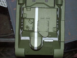

charliec said:
The white stripes on the hull were aircraft identification markings - they were only used at the end of WW2. Similar idea to the stars on the top of US and British tanks in Europe.
Not sure, Jim, but this is what Charlie posted earlier....

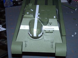

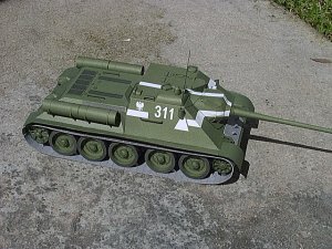

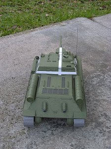

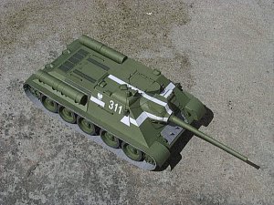

Well, finally have finished the Su-85! The tracks are very simple and I had put some thought into attempting something better, but I think I have had enough of this at this point... I may go back later and do something. Anyway, on to the pictures:
Overall I enjoyed this build, but I did have some problems. The instructions are in Polish and the accompaning diagrams leave much to be desired. For anyone building this model, I recommend looking the road wheels diagrams very closely... Also, the front turrent area is problematic (I believe this is a design flaw). Still, not a difficult model, but with so many others out there with much better instructions, I will probably not revist Answer!
Chris

I think that one looks very good Chris!
Congrats with the build!!
I have to agree with you on the tracks issue :)
But I guess it's not the easiest part to scratchbuild.

Looks very sharp, Chris. Personally, I think the whole tread issue will keep me away from card armor models, so you're a better man than I on that point.
