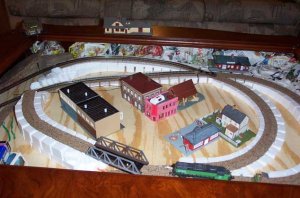

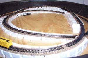

I've used 'em too...
I have to admit that I have always been an overkill type person and if the track wasn't nailed to plywood, then you weren't doing it right. Then I got into building coffee table railroads and tried this stuff. Now I'm hooked although it still feels a little strange "glueing" my track to styrofoam. I used it for extreme grades (as you can squish it together to increase your grade), tight corners (much tighter than standard), and small spaces.

Is the procedure to get everything lined up (foam, corkbed, and track) and then just start glueing????.....Glue the foam down first, then the cork to the foam, and then the track to the cork????.........NO NAILS???.....sounds like it has great posibilities. What kind of glue do you use?

I used Liquid Nails, both the type listed as "for Projects" and for "Foam". I liked the latter better. You can also use white or yellow glue or caulk. I'd stay away from rubber cement or contact cement. Try alittle section first to insure that the glue doesn't eat the foam.

First I glued the inclines and risers to the benchwork, using pins to hold them down. I then glued the cork roadbed to the inclines and risers, again using pins to hold it in place until the glue dried. I'm still doing my trackwork, so haven't glued the track down yet. I've got it held in place with pins as well. (Buy a bunch of "T" pins, they come in real handy). When I'm ready, I plan on ballasting the track and using a water/glue mix to cement the ballast in place and hold the track down as well. Then I'll remove the pins.
As far as the inclines go, my advice is to buy Woodland Scenics. I tried saving a few bucks by making my own inclines and while a couple turned out ok, it wasn't worth the time or mess. Save the money somewhere else. I did make my own risers (flat grade) by using different thicknesses of sheet stryofoam I salvaged from a variety of sources or bought at HD.
