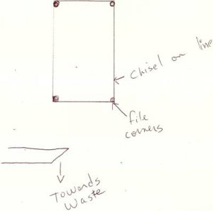

I looked at that page and the method I use wasn't there, so here goes. I drill 4 small holes (.060) as close to the four corners as I can. I then connect the holes with a wood chisel used bevel side inward toward the waste. I use just a light tap with the styrene laying on scrap wood. If I do this right there is now only a small radius left in each corner to be filed out square. I have a 1/2, 3/8, and a 1/4 wood chisel that are used only for this purpose only. This also works on thin wood and paper products too. DASH10
