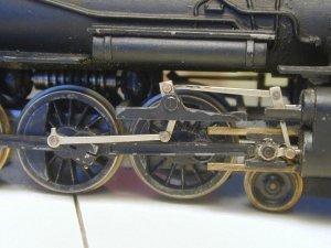

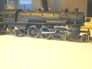

Heres a neat pic of dads kitbuilt Bowser K-11, circa 1950

Hey Arttwmich, I was wondering what was in that Bowser box in your first photo. Nice, is that the NYC Pacific?

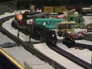

Hi Aart:
When this tread started i think you were asking about ways to create temporary roadways for your friend’s O gauge layout. It's since turned into a discussion of some REALLY nice scale techniques. Kudos to all of you for the lovely work.
If you're still interested in the hi-rail approach, here's a pic of my S gauge module, with some hastily applied "snow" to make it a "holiday" layout, showing the "roofing" roadway i've added to the unit. It’s easy to do and will lay on carpet just fine. I’m getting ready to cut some more for my Christmas layout laid out on the floor of our library.

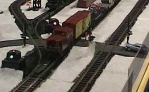

This one shows a little more......
Please forgive the "snowdrift" The GG-1 we were running "plowed it up just before i took the pic.

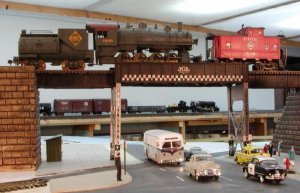

TRflyer, You're quite right, we did stray a bit didn't we? But I was encouraged! Just one more post back to our strayed to topic. I thought rather than have to search for the contest photo to compare teh proto photo to, I would post teh shot here. Then I thought why not reshoot the scene without the local down below and with the bus in the photo instead. Couldn't do that for the contest since the background isn't finished. THEN I thought, I have an Erie loco I built 25 years ago in a box somewhere, why don't I find it and use it in the photo. Well, a half hour later I found it and went ahead and reshot the scene. Now I'm really bummed because the bridge is WAY high! But like you Val, it is going to stay that way! BTW, that's an Athearn 2-8-2 in the background, sans boiler and tender shell. Installed sound and wanted to balance weight but wasn't able to. Pulls 12 cars up my 1 1/2% grade, it'll have to be good enough.

Gary - the last one is great. It seems you have captured the prototype look rather well. Also like the choice of road.

Val, I used brass photetched truss type girders by K&S Engineering. The diagonal bracing section comes attached to a solid section by perforations. I assume it is meant to be bent into half of a box girder. I simply cut the solid section off, filed the edge, and glued styrene strip to form a (I think) plausible structural shape. One of these at each end runs the full length from corner to corner, the other is two sections butted up against the first. I made the gussets from thin styrene (10 or 15 thousanths) trimmed to shape and embossed rivits with a ponce wheel. Fact is they're not that great, but I'm improving. They represent my first riveting attempt.

BTW Gary and Val, your use of a simple street scene (bridge structure, bus, cars, pedestrians et. al.) is really impressive. I hadn't thought about that part of the layout yet but I am now. I just need to get to work on the scenery so that I can try some of the things you guys are doing. Great camera work:) :) :)
